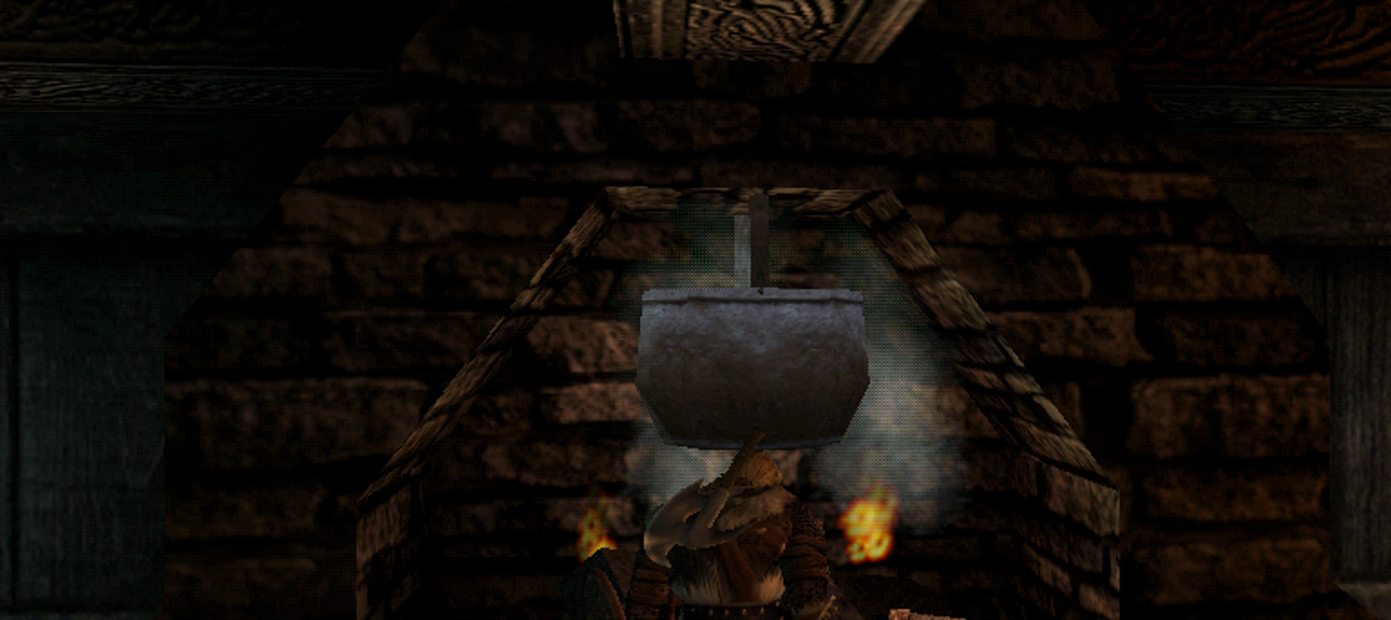

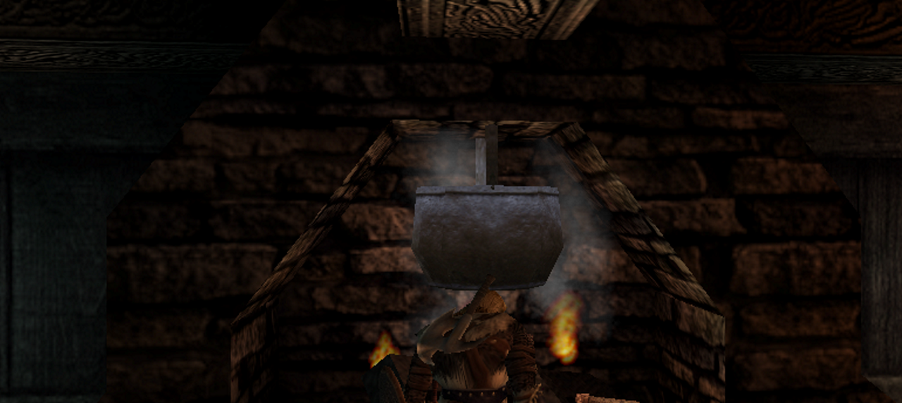

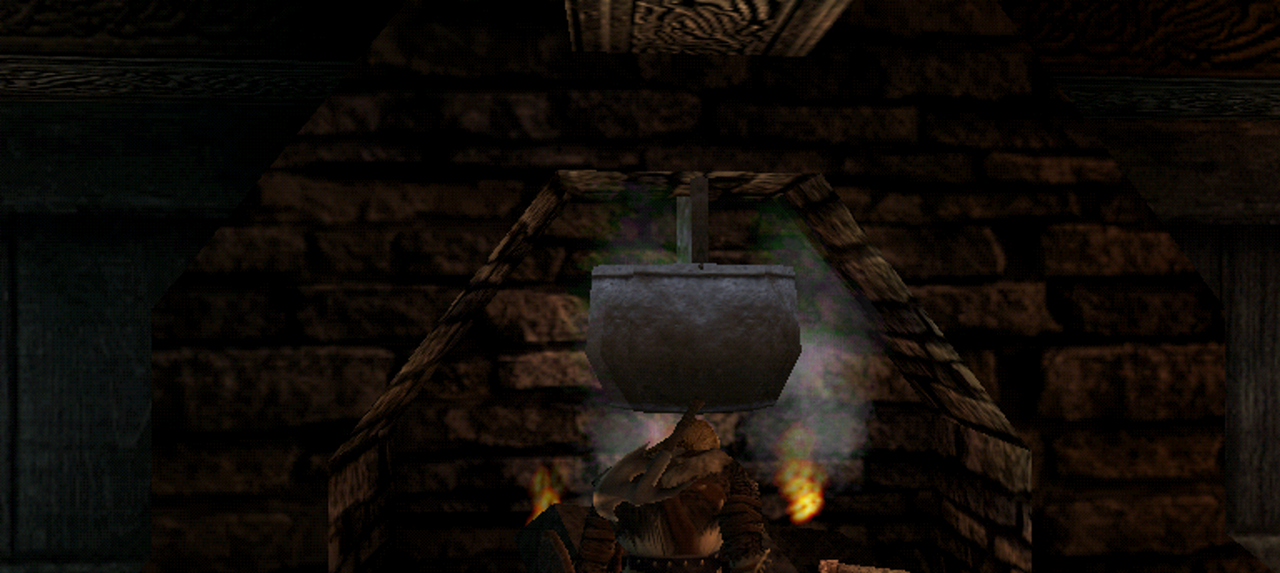

Alpha blending! I always forget whats the "best" setting between sharper and smoother. In all cases, filtering quality was set to High, glide api for the game.
As far as I read online High filtering quality and Sharper alpha blending enables the 3dfx ""22bit"" post process filter(looking at the images would have to disagree). 32bit will ofc always look beter, also drop fps from 80 to 50.
16bit Sharper
https://postimg.cc/9RkdgQQ6
16bit Smoother
https://postimg.cc/Vdnq41Qh
32bit
https://postimg.cc/0zvpB39y
Pictures a bit too small on the forum too see much of a difference, besides the amazing 16bit green-ing. You can open the file link, and then you are able to zoom.
Sharper will show those
Zoomed
16bit Sharper
16bit Smoother
32bit
Looking at it, Smoother (I guess it dithers the colors?) looks like the better option between the two. If theres fps to spare then 32bit.
After some more playing with it, I will stick with sharper. Smoother, while nice for some fx, does make the image a bit murky.

The problem is, screenshots can't capture that 3dfx "22bit" post process filter, because it is done AFTER the framebuffer. There was quite a fuss about it back in the day.

From your screenshots I prefer 'smooth' 16bit, why? I know, confusing right? Well, 'back in the day' I always loved my 3dfx in 16bit colour mode because all effects like smoke-trails were nicely smoothed and transparent, when I 'upgraded' to a TNT2 later I was massively dissapointed by it's horrible grainy 16bit colour, I missed that '3dfx filter'. By using the 'smooth' 16bit blending this is the look that I always loved, so even though I can run 32bit colour, I think - why? Then it just looks like any normal Nvidia card, boring... The lovely 16bit smooth dither gives my games that beautiful 3dfx 'look' while also being faster than 32bit. This is my own personal reasoning 😀

Yes I did add that sentence at the end, sharper alphablending is the way to go. The card really has nice image quality, up to a point. For q3 and beyond, you can get better with 32bit and aa and af with other cards, but for 16bit titles, it just renders such a nice picture. Its really a joy to play those older games on it.

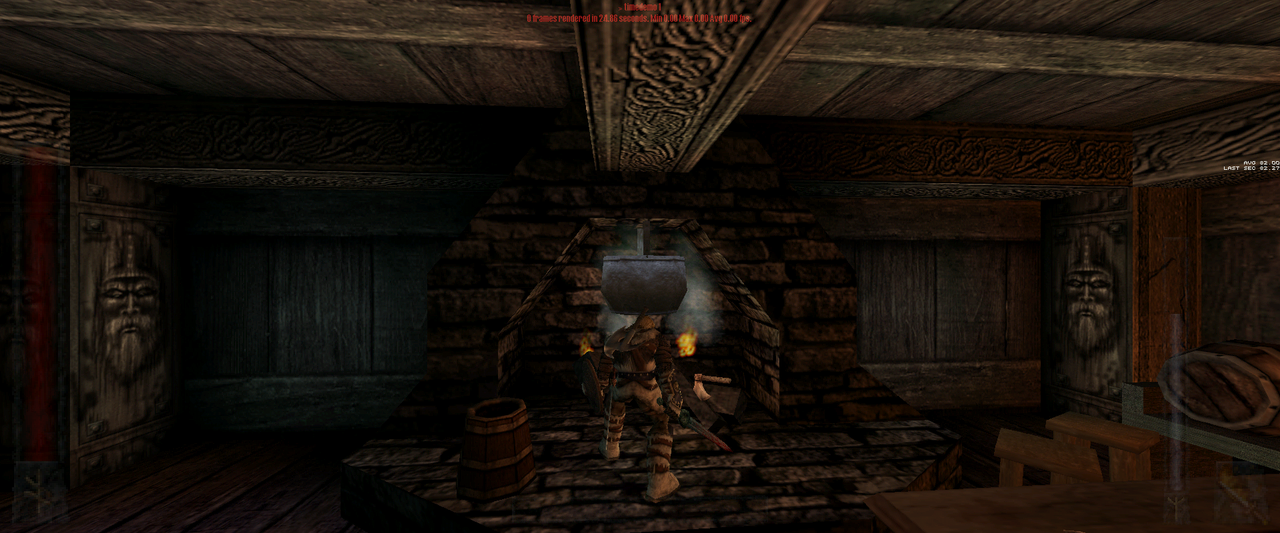

Ive been playing some some Quake1 (and all its milion expansions) and on my win10 machine, I preffer the nonfiltered look. But on v5 even filtered looks, well great, sharpnes is right, contrast is right, colors are really nice(all shades of brown!).
You can mixmatch basicly everything in the drivers, there is some crosstalk between parts of the driver, but generaly most things go. If you want to try sfft-s core, you can replace 3dfxvs.dll and 3dfxvsm.sys from his package. It does have the most advanced/correct d3d implementation. That one game(drakan) I tested didnt work right, but I use XP mostly for newer d3d games and so far everything I tried it chugs allong great.
The driver I added (3dfx wide driver, for win9x), uses Koolsmokys glide3 as base, with some improvements from the sourceforge glide project ported, glide2->glide3 wrapper (fixes some stuff this way), Mesafx6.2 for openGl with some additional settings. If you used mesaFx before, you probably noticed its a bit slow for some games, well its not, it just defaults to 32bit, so override is added. Theres a topic for it on 3dfxzone and on side 2, at the bottom instructions what do do for XP, if you wanna give it a try.
I tried sage, when I was looking for an icd, but the first game (q2) I tried, already had problems. There is an updated version on github, that you can build yourself, but at that point I kinda wanted to go the mesa way.
I will get to XP eventually, but since all the testing takes so long, and if something is actually broken then to fix it... not really on the menu right now. Wanna do newer mesa first.
But if I wanted to mix the ultimate driver!!!!!!, I would probably use sfft1.9 as base and mix in wide driver glide23/opengl+reg 😜
(I swear my plan was to make a very short post, but... might as well add a picture!)

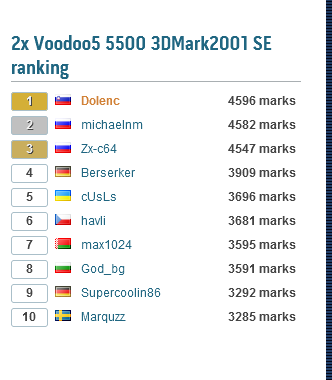

Long time no voodoo!
Card got some faster 5ns memory(not that it gives anything) and then it got stuck in a limbo for a while.... Where it still is ...
It works fine with atx power supplies but locks up in sli on game open with sfx psus, tried 4 different kind. There isnt really people out there with rev320 chips, using sfx psus, on agp1.5, that we can exchange experiences. And its been on plenty of different atx psus, where it works just flawless. Card has been traveling (way)more than me.. Limbo!
But when it works, its a world-epen breaking card!
https://hwbot.org/submission/5217387_dolenc_3 … 5500_4596_marks

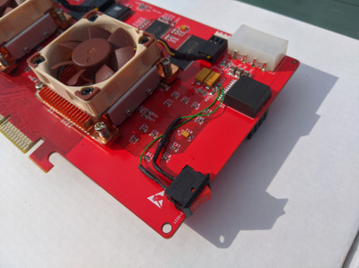

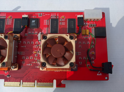

Additional heat output is manageable but noticale(200mhz@3v), power delivery section also heats up more. And I do play all my old games on the system, dont want it to die prematurely.
So while I had my shitty soldering "corrected", additional switch was added. It now toggles between default 2.8v and 3.0v to the core.

where can i buy a cooper cooler like you use on your card?
Zalman Z-Machine GT1000|CPU Athlon 64 FX-60 |MB Asus A8V-Deluxe|RAM 4x512MB Corsair XMS Pro DDR400 |SSD 1x Transcend PSD330 128GB IDE |GPU HIS HD3850 IceQ 3 Turbo AGP + Changeling 3dfx V5500 PCI |Sound Audigy 2 ZS
Reply 74 of 98, by Nuka-Cola Quantum
Many Thanks soon i will get me V5500 Changeling PCI and that cooler it's a must if you ask me its beautiful
dit you remove that foam under the cooler?
Reply 75 of 98, by Dolenc
Either removed it or didnt come installed, forgot, its been a while. They do look nice.
You can also ask Anthony if he still has some and ship the card with these, not the alu one(if its a compatible model card).

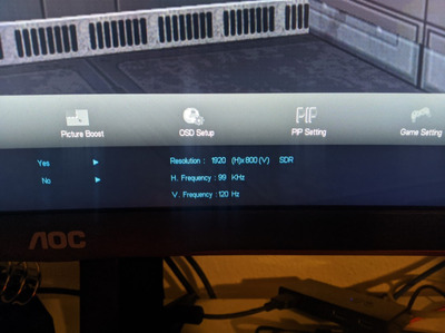

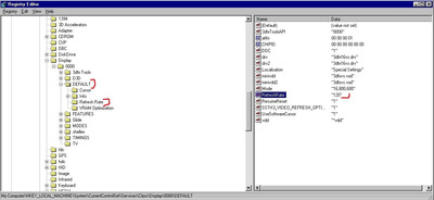

So Ive been playing System shock 2, which is a d3d title... And had some unpleasant screen tearing. D3d titles seem to defaut to 75hz refresh rate, whats set in the registry. I know this for a while, just now was the time to get to it and change it.
I looked if theres a registry value that affects this (yes yes V.control Ill get to that) and ofc there is.
So I added it to 3dfx tools with a registry addition.
It changes this setting, that I guess d3d part of the driver reads.
82.34 KiB
1013 views
83.88 KiB
1013 views
If refresh doesnt go as high in display settings for the adapter it will pick the closest one.
Didnt do extensive testing and I only tried with Widescreen driver, but here works fine, as expected!!!
(I also remember seeing the setting in some other driver and it didnt do shit, I guess it did in d3d)
