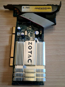

Reply 26 of 36, by Cuttoon
Sunflux wrote on 2022-02-27, 16:57:
So… why are they cheap?
Well, generally speaking, they're cheap because they don't fit in PCIe slots, don't support SLI and a contemporary RTX 3090 Ti has overall better 3d performance 😜
The FX 5xxx series generally has a bad rep. Dunno why, but apparently wasn't Nvidias finest hour.
Phil has a bit of an obsession with them:
https://www.youtube.com/watch?v=rc4vivgEriU
Including the Fx5200 which was available in plain old PCI, as one of the last cards ever.
There's also the Gf6 6200, as a PCI card, not even that rare. Zotac was a common brand, around for 20 bucks maybe.
As I understand it, those cards in old systems only make some academic sense if you want to exclude the graphics as a bottleneck or try certain features or benchmarks.
I'd rather go for period correct stuff, but that sureley is a matter of taste.
