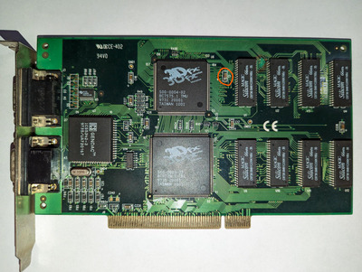

Hi,
I am new here. Saw a few videos on YouTube about repairing Voodoo cards and this forum was mentioned a few times.
First I want to start with my Voodoo 1.

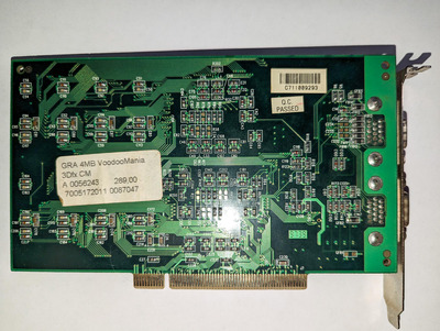

According to the sticker, it is a VoodooMania Card.
I bought it on eBay a few years ago, “working”. As you may guess, it is not. Drivers are installed, but the card will not initialize.

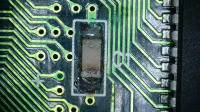

So I bought a Microscope yesterday and looked a bit around and found a broken part. C1 is split in half.
604.48 KiB
394 views
I did not find anything else mission or broken, so it seems that this maybe it.
Is there a way to find out what component that is, or do somebody know what I can use to replace it?

Reply 2 of 10, by Doornkaat
Welcome to the forum! 😃
That's a ceramic capacitor and it helps with stabilising power required by closeby chips.
It likely shorted and it's plausible this would cause issues. It looks a bit burnt as well which means the pads underneath may lift when you remove it so be careful.

Reply 3 of 10, by CheruPrime
Hi,
I removed the part and it works now better but still not. I now See the RAM in the Driver and Driver Tab will Not Crash randomly.
But unreal still complaits and Halflife wont Go further than "loading".
Are there any Things that i should Check that are Always broken?
Reply 4 of 10, by Tiido
The big chips often develop bad solders with some (sometimes a lot of) pins coming loose from the board. I use a needle to gently skate it across the pins and the loose ones will easily show up. Good amount of flux and clean tip with a flat edge will be able to get things soldered down properly again but if you have not worked with 0.5mm pitch parts before you really want to exercise on some other board with minimal importance to learn the process.

Reply 6 of 10, by CheruPrime
Thank you all so far!
I found a pin that was loose, but on further inspection it shows, that it is soldered to the pad, but the pad floats on the PCB... But there is connection between this pin and the other side, so it is connected. I resoldered a few pins that seemed suspicious.
I then tried mojo from the SDK and it detected everything fine, but Unreal would still error out at start with a 3dfx expected, not found error. Hm.

Reply 7 of 10, by Doornkaat
Did you replace the original suspicious capacitor? Maybe it is crucial to operation.
Also are you using original drivers or something like fastvoodoo that overclocks the card? Some aren't stable with those?

Reply 9 of 10, by Garrett W
Try something other than Unreal, especially if you are running an original, unpatched version, perhaps it has issues detecting the Voodoo using later drivers.
Try Tomb Raider with the 3Dfx patch under DOS and some other Glide game in Windows.
Reply 10 of 10, by CheruPrime
Ok, it can run Tomb Raider 2 and 3D Mark 99!
So the hardware is ok-ish after the removal of the cap, but the software is ... I will reinstall Windows just to be shure.
