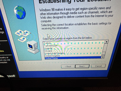

First post, by seiko4169

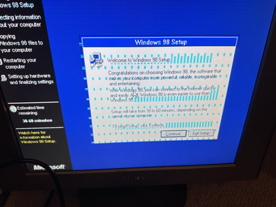

Just picked up a 9700 Pro. Post screen looked good with no artefacts but as soon as the Windows 98 Installer starts the screens show a large number of artifacts? It’s running on a new PSU (500w) and old ASUs P4S800 Mobo. I’m just waiting for a new drive to arrive and I’ll try installing XP but is this card already on the way out?
I’ve tried another card and no artifacts?
Return to sender?

I recently observed similar symptoms on a Radeon 9600 Pro, and did some research. The issue on that card were clearly related with unusual waveforms on the data strobe line (DQS) on one of the DDR memory chips. It seems the DC level on that line drifts in ways all the other DQS lines didn't drift. I tried adding pull-up/pull-down/termination resistors to stabilize the DC level, but only managed to get partial improvements that also varied a lot with card temperature. I was able to source a Radeon 9600XT for a price I considered "very acceptable" and decided to ditch the Pro card.
In case the symptons on your card are temperature dependent (gets worse or better during the run time of the computer), and you don't have similar issues with other AGP cards, it is extremely likely that this card is damaged. If you have the option to return the card to the seller (especially if it's a commercial one), do it.

Thanks, after installing win98 (waiting for my XP disk to arrive) and switching to a decent res and true colour it’s actually very difficult to pick up any corruption. It’s there but very subtle.
I’ve messaged the seller to ask a return.
Shame, I had a no idea the great ATI 9700 pro’s ended this way. Such an amazing card back in the day!!

Nothing much we can do, the cards were flawed from a design point which carried over to fabrication, my guess is the heat of being powered up and used after a decade of sitting around cracks solder joints under the die and BGA Vram, they were fab around the time that nasty ROHS compliant lead free solder was bought in and its honestly the biggest killer of hardware of this period next to the cap plague.
So all we can do is keep buying the cards and collect the working ones and try our best to repair the dying damaged cards.
IIRC there was also some really bad BGA VRam used, I cant remember off the top of my head what brand it was but it goes bad more often than not. Quick skim above and its Samsung BGA modules.

My experience is similar to TrashPanda. All early BGA vram cards are prone to fail for solder connection / thermal expansion. Reseating or replacing memory chips fixes this (temporarily)
I have repaired FX 5900U and couple ATI 9600pro cards which were confirmed working by reliable seller. Sending cards with post even with good packaging can break them causing tiny cracks in solder.
