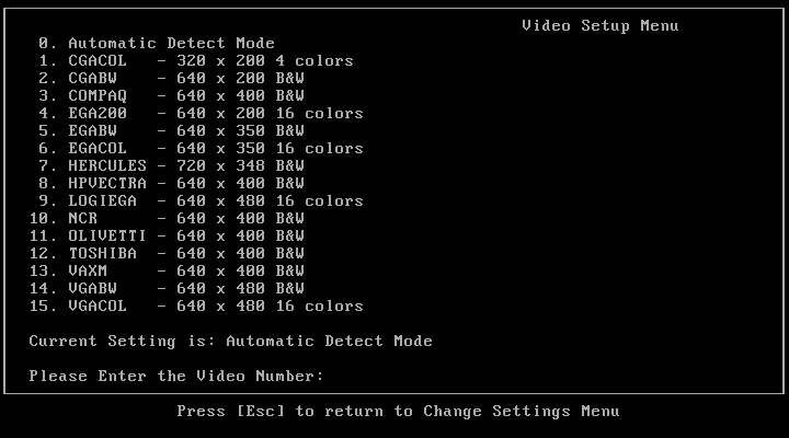

Hi everyone,
Just played around with an old copy of Logitech's PaintShow Plus..
To my surprise, it lists quite a few 640x400 b/w modes I haven't of heard yet.
Are they related to the famous Olivetti M24 mode, perhaps ?
Here's the list:
COMPAQ - 640 x 400 B&W
HPVECTRA - 640 x 400 B&W
NCR - 640 x 400 B&W
OLIVETTI - 640 x 400 B&W
TOSHIBA - 640 x 400 B&W
VAXM - 640 x 400 B&W
Here are a few /related ?) computer models that I've information for..:
NCR PC4: https://www.old-computers.com/museum/computer.asp?c=539
Toshiba T1000LE : https://en.wikipedia.org/wiki/Toshiba_T1000LE
Compaq Portable III: https://www.seasip.info/VintagePC/compaq3.html ; https://www.old-computers.com/museum/computer … asp?st=1&c=1064
HP Vectra (original series): http://www.hpmuseum.net/pdf/HPChannels_1987_1 … s_Oct87_OCR.pdf
Sadly, I couldn't find any information about the last video type (VAXM). Any ideas ?
Thanks in advance.
Best regards,
Jo22
    5.77 KiB
    1160 views
    PaintShow Plus 2.21 video modes list
Reply 1 of 19, by Predator99
Interesting...seems the Olivetti card I got recently also can do this mode:
Olivetti GO423 (Positive Graphics Controller)
https://minuszerodegrees.net/manuals/Olivetti … 20computers.pdf
Havent tested it so far and dont think it works without repair.
Reply 2 of 19, by Grzyb
ZSoft PC Paintbrush from 1985 lists some more 640x400 monochrome modes:
AT&T 6300 High Res
Corona Computer
Persyst BOB Board
Tecmar Graphics Master (but there's also the 16-color mode)

Reply 3 of 19, by Grzyb
Jo22 wrote on 2023-03-24, 13:14:
Must be DEC VAXmate - https://www.vt100.net/manx/details/1,3548
Żywotwór planetarny, jego gnijące błoto, jest świtem egzystencji, fazą wstępną, i wyłoni się z krwawych ciastomózgowych miedź miłująca...
Reply 4 of 19, by Jo22
Grzyb wrote on 2023-03-25, 11:10:
That's it! Thank you very much, Grzyb! 😃

Reply 6 of 19, by Grzyb
There were two approaches to the 640x400 resolution:
- use a regular CGA monitor (15 kHz HSYNC) with interlace, eg. Tecmar Graphics Master
- use a dedicated monitor (most likely 31 kHz HSYNC), eg. DEC VAXmate

Reply 7 of 19, by VileR
The Olivetti, Compaq, and Toshiba should be the same mode as the AT&T 6300's. AT&T's machine was a rebadged Olivetti M24; the Compaq Portable III (and 386) implemented a compatible video subsystem, as did Toshiba's T3000/T5000 series.
IIRC, some pre-EGA GRiD machines (GRiDCase 15x0?) were compatible with it as well. 640x400 was popular with early portables, since they could easily pixel-double CGA graphics and still offer crisper 8x16-dot text.
The Tandy 2000 (not quite PC compatible) also had a 640x400 B&W video mode. Probably more widely used than its color counterpart - 31 KHz color monitors were expensive, and the 2K's hi-res color mode was extremely S-L-O-W due to the architecture.
