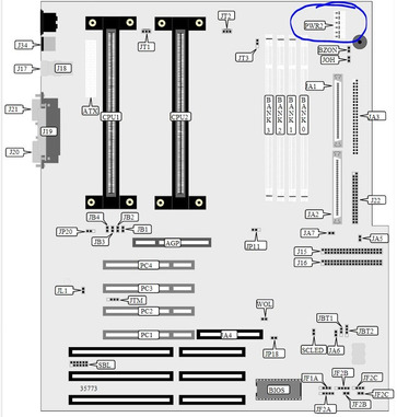

I need help to overcome system problem of not being able to run V2 in SLI in a multiprocessor PC.

Problem I am experiencing is that the V2 cards are present and recognized in system (and also 3dfx control panel), but they simply do not work - when I try to run glide demo (such as Borg or Donut), let alone try a game, the screen goes black, monitor shows that it is receiving signal, sound continues, but no image. I tried several drivers for Win 2K, such as official 1.02, Gold drivers 4.0 and PeDiniz (recommended by a friend), and none of them seem to work.

OK; update (all tests are done under Win 2K, DX9.0b, drivers 3dfx v1.02 / Gold drivers v4.0)
1 CPU - 1 card -> works OK (tried with both cards separately, to check for possibility of faulty card)
1 CPU - 2 cards -> SLI works, but freezes after a few seconds, seems that they become de-synchronized (I see horizontal misalignment)
2 CPUs - 2 cards -> no-go, still black screen.
I've seen another symptom on this motherboard which seems interesting - Supermicro p6DGS is AGP 2x capable, but seems that it don't have very strong power delivery to AGP slot - anything stronger that a geforce 2 (tried gf3ti, gf4ti, even Radeon 900o) - it shows corruption in screen or just blacks out before it reaches windows.
Worked OK with Ati Rage 128 Pro, RIva TNT2 m64 and GF2mx400.
If I have time today, I will try to install Win2k yet another time, just this time, will try to hit "F5" during installation and choone Multiprocessor ACPI instead of MPS, to see it if will work...
EDIT: I've noticed that the MB has auxiliary power supply connector on the upper right corner - do you think it's needed for the proper functioning of the board? the previous owner told me he used the board without it (without any problems), and so far I'd say that also in my case it is working fine (except for the AGP stronger cards issue).
Reply 7 of 8, by matze79
At least its worth to try it, it provides additional 2 3,3V Power Lines and one 5V Power Line.
The Voodoo 2 should only use 5V from Slot as far as i know.
It has own Voltage Regulator onboard.
What PSU do you use ?
If its a modern PSU it likley has not enough Amps on 5V.
Reply 8 of 8, by BoYan
I found out my PSU has additional 6-pin connector and connected it, and voila - all started working as it should. Me very happy 😊
