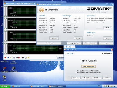

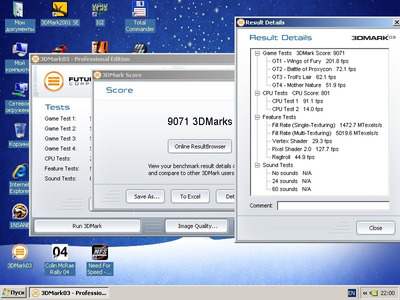

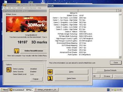

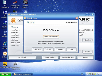

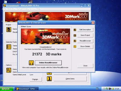

While i looked my results i made long ago. I noticed that 3dmark scores is qiute low as usual it around 11K while mine results was 9k in 3Dmark 03. Card is Sparkle Gf 6800Gt with 350/900mhz . Driver version was forceware 80 -90
What can cause such a big performance drop ? Even on quad q6600 ?
Here is some pics:

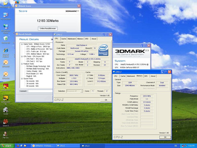

The p4 results look correct, but yes definitely the Q6600 numbers are low.
Reply 3 of 5, by cyclone3d
What bus speed are the P4 and Q6600 running at?
Is the RAM running at 1:1 with the fsb?

Reply 4 of 5, by Imperious
p4 Northwood @3.6ghz with 6800GT

both results are low , its perform like 6800
P4 is 3.3 ghz with fsb 215 and ratio 1:1
Q6600 ran at stock speed
Imperious wrote on 2023-04-01, 09:21:
Yeah thats how it should perform ill do another tests and check if anything changes
