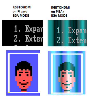

I'm experimenting with RGBToHDMI (https://github.com/hoglet67/RGBtoHDMI i'm using the latest stable release 20221221_156e2f0 Release )
It works superbly on a pi zero, but have some strange effect on my pi3A+ with exactly the same SD card.
I have only one pi zero, and a lot of pi 3A+, so it would be great if i can get it to work nicely.
Here's some screen captures I took :
On the pi zero, all is fine and nice :
Zero with maniac mansion :

On the PI3A+, exactly same setup, same SD card,i get cyan stripes.
PI3A+ with maniac mansion :
8.07 KiB
No downloads
PI3A+ at the boot menu
9.31 KiB
No downloads
Here is a zoom in on the problem :
12.55 KiB
380 views
I hope i could just change some setting and make it work on pi3a+ as well.

Reply 1 of 2, by dreamblaster
Problem solved -- the pi3a+ was broken apparently, with another one it works fine.
so now it works just as well on pi zero as on pi 3a+.
only this specific pi3a+ had such artefacts, another doesnt
