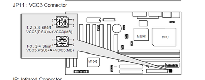

Reply 33 of 52, by shevalier
Minutemanqvs wrote on 2023-05-07, 08:12:
Then we have the area just above the AGP slot, I guess it's a VRM for AGP.
According to the manual, this is +3.3V system power.
In general, everything was powered from it in those days, starting from the memory and the chipset.
Again, no one is forcing you to use it.There is a jp11 jumper for that.
    18.46 KiB
    426 views
Aopen MX3S, PIII-S Tualatin 1133, Radeon 9800Pro@XT BIOS, Diamond monster sound MX300
JetWay K8T8AS, Athlon DH-E6 3000+, Radeon HD2600Pro AGP, Audigy 2 Value
Reply 34 of 52, by Minutemanqvs
shevalier wrote on 2023-05-07, 09:27:
According to the manual, this is +3.3V system power. In general, everything was powered from it in those days, starting from the […]
I m'not sure to understand what this jumper does, by default it's on 1-3,2-4 on both of my GA-5AX boards. Of course I don't know what previous owner did...
Does it mean that:
1-2,3-4 = use the 3.3V directly from the PSU
1-3,2-4 = convert 3.3V on the mainboard
Why would that be on 1-3,2-4 by default? Because some power supplies couldn't provide enough current on 3.3V? To have a more stable 3.3V than relying on what is provided by a crappy power supply?
Oh and I also see there is another jumper dealing with 3.3V, to basically over-volt it. Previous PCB versions of the GA-5AX don't have this jumper.

Reply 35 of 52, by Minutemanqvs
The result in interesting to say the least...
With setting 1-3,2-4:
With settings 1-2,3-4 no more heat. If I understand correctly this regulator is completely bypassed:
I guess a 50€ thermal camera is useful after all.
Searching a Ride mP6, PM me if you have one.

Reply 39 of 52, by frankmonk
Minutemanqvs wrote on 2023-05-07, 10:49:
I m'not sure to understand what this jumper does, by default it's on 1-3,2-4 on both of my GA-5AX boards. Of course I don't know […]
Does it mean that:
That's actually a good question. I'm also not sure which jumper setting would be optimal. I left it on default as well.
