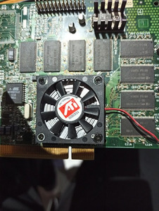

Reply 17 of 17, by DesktopDynamite
I have recently installed a small cooler/heatsink combo, since mine came with a super small passive heatsink... My aim was to install some type of cooling solution, but at the same time insisted to still have space underneath, if I wish to install other PCI expansion card...
