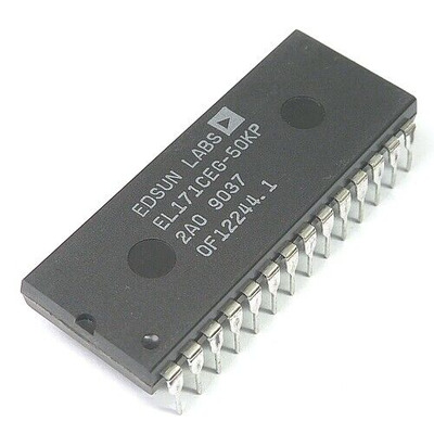

The seller from Poland on eBay is tvsat_electronic. Attached is a photo of the Edsun CEG RAMDAC chip from their eBay listing. Notice the date code on the chip of 9037. Definitely from the 37th week of 1990 and exactly from the time period these chips were released.

Yep that's the one 😀 I bought some SiS chipset QFP chips from them and they were new with no solder on the legs and packaged properly. Your chips should be good too I suspect.
Should be interesting to see if it works and if it makes an appreciable difference. Since you're working with the DIP version rather than the PLCC44 version, the pinout should be the same as most RAMDACs in that package. I did notice a couple of CEG specific pins on the PLCC44 version though, which are n/c on regular RAMDACs.

At the very least it should act as a normal 8-bit color RAMDAC if it is truly a drop in replacement. To get the Anti Aliasing features, you need to include that logic in your graphics code. Too bad it is not automatic, but we are talking 1990 technology after all:)

The ebay listings say they're ADV476 compatible which would only be 6-bit color (18-bit RGB).

Thanks for the correction!

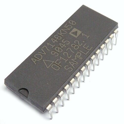

I was also able to source a ADV7146 CEG RAMDAC from tvsat_electronic in Poland. It should be interesting to see if this is much different the Edsun CEG EL171 RAMDAC.

I got the Edsun EL171 CEG RAMDACs today. I installed one and did some testing. Static images look fine, but when doing cycle cycling the picture has interference. I think the issue may be that the EL171 is running at 50MHz and the Samsung RAMDAC I took out runs at 80MHz. I have a ADV7146 coming and I hope that one will work out better.

50 vs 80MHz is maximum pixel clock rating, and pixel clock depends on currently selected resolution. 50MHz one tops out at 1024 x 768, the 80MHz one allows 1028 x 1024. When used at 320/640 x 200/400/480 this will not be a limiting factor at all.

I spoke a little bit too soon. I tried the video card and Edsun RAMDAC in different computer and all is working normally. I think the issue is I am running bus timings a little too aggressive on the other computer for the video card too handle.

I've got and tested the EL171CEG chips today, and they work perfectly fine on my OTI-087X. Video output is a bit worse compared to the original MX86487PC, as black colors are now mostly grey. Very similar to what S3 Trio cards output.
