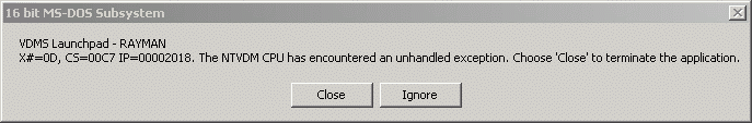

Originally posted by Twinsen When I lauch the game, here's what I get (in french) : " Sous-système MS-DOS 16 bits D:\Jeux\Raym […]
D:\Jeux\Rayman\Rayman\Rayman.exe
X#=OD, CS=00C7 IP=00002018. Le processeur NTVDM a rencontré une exception non gérée. Choississez Fermer pour mettre fin ß l'application "

Trying to run the standard Rayman from "Rayman Forever" was the real eye-opener. It resulted in the error you see in the image attached to this post. Twinsen should recognize it as the English version of the same message that he has been getting.
Very, very interesting. So UbiSoft apparently had more than one version of the "basic" RayMan. Unfortunately, that effectively kills any chance of running it in XP without full emulation.

Yes Nicht, this is the same window error I get in french...

Originally posted by Twinsen There's a french web site : ShinoD7, which has concieved a "simplified" boot disk, to play DOS games (which can't be run even with VDMS) under XP.
The problem isn't VDMSound, it's the NTVDM of 2000 and XP. If the program can't even run in XP, then it can't run with VDMSound.
