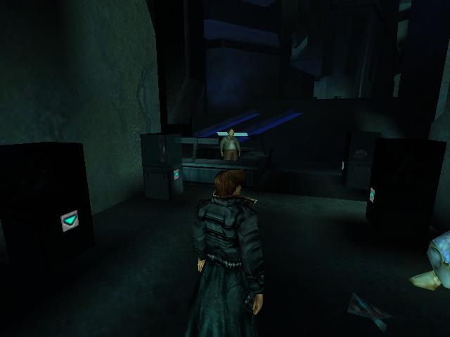

Davros wrote:
Is this the same location as your first screenshot ?
Almost. Wrong blending is in the lift only. Lift glass must be fully transparent.
I have attached the fraps movie to show the effect exactly. http://www.4shared.com/video/9fh9A_78/Anox.html
what would happen if you try and leave the starting map without buying a battery for pal ?
IIRC you can't enter the bus to the Spaceport, Boots will say something about "I need my old friend".

Reply 27 of 32, by Gamecollector
No, GOG version have the transparency glitch.
More places to see this: Mystech Museum (demonstration cases), bookstore in Tenements (front glass)
Plus it looks like there is no fog in museum with Radeon HD2600.
