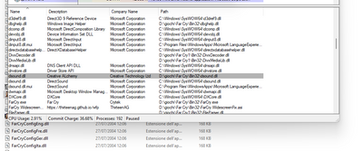

Reply 312 of 389, by Kappa971
Far Cry works weird, it allows you to select "Hardware mixing" and "EAX 2.0" even without EAX compatible hardware, but EAX doesn't work. This probably makes many people think that DSOAL is working but it isn't. In the log file, there is no reference to EAX (in other games it is present).
I have used ProcessExplorer to see if DSOAL's dsound.dll was loading, it loads but apparently does nothing. Using the same program, I checked what happens differently with ALchemy: in addition to the ALchemy dsound.dll, the Windows one present in C:\Windows\SysWOW64 and a dsound.dll.mui file are also loaded (Screenshots attached) .
This is beyond my knowledge.
