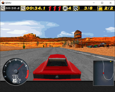

Reply 40 of 82, by kjliew
With modern technologies and virtualization, getting such an old game to run native is a futile attempt. It is overly complicated and has the tendency to break the OS. QEMU WHPX on Windows 10 x64 runs the game just fine without any patches. Simply run a Win98SE VM, run the installer and play, that's it.
350.71 KiB

Reply 41 of 82, by BEEN_Nath_58
kjliew wrote on 2020-08-24, 20:37:
I am temporarily playing it on QEMU, but more than the breaking of the OS, I am concerned with the fact that it runs on the same OS(Win10) on one PC but doesnt on another PC.

Reply 44 of 82, by kjliew
xcomcmdr wrote on 2020-08-25, 07:29:
QEMU is a fine option, but like PCem it really needs a PC that can accept the huge performance hit. Most people don't own such a PC.
Besides, Windows 9X tends to be very fragile.
For this one, no you don't. With WHPX/KVM, the game plays very smoothly from Win98SE VM on Core i3-4010U laptop. QEMU with acceleration is way ahead of PCem in performance because virtualization runs the codes most of the time at bare-metal.
Discrete_BOB_058 wrote on 2020-08-25, 08:28:
The game crashes 75 perc of time on Win98, and the VM is not stable with other operations too.
I see that you have a Ryzen from your signature. Perhaps there are issues with how Ryzen deals with virtualization which I do agree that Win98SE VM is more tricky with Ryzen and I have the same problem with my Ryzen 2500U APU laptop. The old FX and Intel CPUs are better at Win98SE VM with QEMU. WinME/Win2k/WinXP VMs are fine on Ryzen as far as I can see. I did not have the game crashed on me for Win98SE VM, audio sounded normal and I could finish a head-to-head match on the rusty dessert course.
If you have high-clocked performance class CPU, then you don't even need to enable WHPX/KVM to play this game. QEMU TCG has ample performance head room to run this game smoothly and Win98SE VM is stable on QEMU TCG.

Ryzen 1st gen has a VME bug and it remained unfixed till the 2nd Gen(some 2nd gen users also report this problem), the fix was to disable 32 bit drivers. Yes the game runs fine and fast but I hate the crashes.
Meanwhile, I shall give a last attempt to run this on both of my native machines, I shall try them at same time, it worked on one and didn't on another, and I hope I can find out something.

Reply 51 of 82, by BEEN_Nath_58
Ok the good news is it now WORKS on all of my Windows 10 PCs.
I reinstalled Windows 10 on all PCs with a local account and without password. After that I installed the drivers. Then I installed DOSBox to install the game.
I copied the iforce.dll to game directory and also NFS win.exe and renamed it to NFS.exe.
I then took dplayx.dll from SysWOW64 to game directory and then launched the game with DxWnd with a certain profile that you will get in page 2.of this thread. You then should get an error of ordinal.2 from dplay dll. Use the dplay dll from Redist folder of the game and then launch the game from DxWnd. You will get errors regarding dpwsock and something else, click OK.there.and the game will launch.
Edit: the Windows 10 20H2 dplayx.dll works.

Reply 52 of 82, by BEEN_Nath_58
I found the culprit of my PC:
I installed driver for C Media Headset even though PC works without it, after installing the game doesn't work.
I uninstalled and it works. I double checked.
