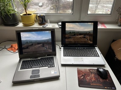

Reply 7 of 24, by vorob

Thanks, try new game in 1024x768, same scene. That's what i have:
207.12 KiB
1531 views
Left one is pentium m 1600mhz with geforce 4200 and right one is core duo 1800mhz with ati x1900.
