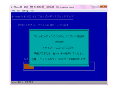

Uhm, sorry for posting here, but I've got a question about PCem. Hope it is okay..:
Is it possible with the current version of PCem to install DOS/V ? I can't get past the first few seconds of the the installation program.
When DOS asks for another diskette, and I do insert the right one, it refuses to use it.
Edit: Found the issue, it works now. ^^ Turned out DOS didn't ask for the startup disk, but wanted to create one.
Apparently, DOS/V refused to use a pre-formatted HDD image for its installation. Using a blank one worked.

Hi, thanks dude! It's not the first time I had problems with images. Perhaps something is wrong with my disk images ?
I created them myself with WinImage. Same issue appeared with DOS Plus, for some reason I can't install it in PCem (though booting works).
It's just strange that they do work on my old computers. Perhaps these OSes do strange things with the hardware, dunno.

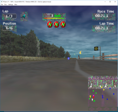

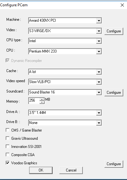

Outrage working in Pcem v11 with Windows 98SE in D3D (with minor graphics corruption).
I've been going through the non-working games on my compatibility list as well as the games I currently have to use VPC and vmware for. So far I've gotten far better results with pcem.
