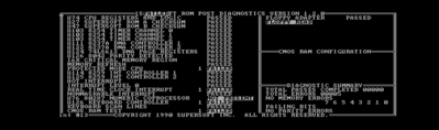

Reply 147 of 151, by superfury
I've just modified the BIOS to be able to use practically any ROM size with it's seperated ROMs. I've started the ROM from minuszerodegrees for diagnostics (http://www.minuszerodegrees.net/supersoft_lan … dmark%20ROM.htm). I'm using the 5170 version:
18.31 KiB
491 views
ROM POST Diagnostics, before clearing the screen
7.54 KiB
No downloads
ROM POST Diagnostics, before restarting all tests.
Of course it's running on the CGA emulation(which itself runs on top of the VGA emulation(CGA compatibility layer) in RGB mode.
So the following tests fail with a 1 before the failed:
- Protected Mode CPU
- Real Time Clock Interrupt
- U126 keyboard controller
- CMOS RAM test
After Floppy Adapter passes and Floppy Read starts reading the floppy, the screen clears and corrupted input is displayed for a moment, after which the second capture displays:
- Floppy Read 1 failed.
- MDA Memory Not Pres
So now, apparently the CPU, RTC, keyboard controller(8042&PS/2 keyboard), CMOS RAM(???), FDC and CGA fail? Anyone can explain what's being tested there?

Reply 148 of 151, by vladstamate
The CMOS RAM testing is basically outputs to 0x70 followed by outputs/inputs to 0x71. So they write an offset, then write some data to that offset via 0x71 then read it back, also via 0x71. If it does not match it fails.
The real time clock interrupt is 0x1A right?
I would suggest however running the XT testing ROM from minuszerodegrees. It is somewhat simpler than it's AT version and you can work your issues there first.
Reply 149 of 151, by superfury
The RTC is connected to IRQ8, which usually maps to interrupt 50h, if I'm not mistaken?
It gives a lot of strange errors during the XT (on a XT with 80286 connected). Most of the display is corrupted after the first 5-10 tests. (it gives the same as the 31_ROMPOSTDIAGNOSTICS2.png given earlier). It seems to reboot without restoring it though.
Beep recording of the beep errors of the XT diagnostics(XT architecture with 80286 fitted in UniPCemu, by selecting XT architecture and 80286 CPU):
https://www.dropbox.com/s/f74k6en30a56blg/Uni … 3_1423.zip?dl=0
It sounds like it's rebooting in there somewhere, but that doesn't clear the screen for new output.
UniPCemu Git repository
Reply 150 of 151, by vladstamate
No, IRQ8 should be interrupt 70h if the default vector is 0x70 for second PIC. However the setting and manipulation of RTC is done also via ports 0x70 and 0x71 so it seems to be you might have a problem with CMOS/RTC emulation, since the BIOS also complains about CMOS memory.
Also I do not think the test BIOS should be rebooting at least not the 5160 one (it is possible the AT one, the 5170 will because it needs to get out of protected mode). Is it possible that the restart is a side-effect of a bug that you might have?
