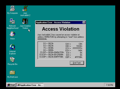

Reply 571 of 577, by superfury
Just fixed some issues with x86 modr/m SIB decoding. Now the case of [EBP] with MOD being 0 will properly apply the offset combined with index as it's supposed to, as will [EBP+imm8/imm32].
Basically, this fixes the case of [index*n+disp32] to behave properly (instead of being reduced to just [disp32] due to incorrect clearing of the immediate).
Although it was Jazz Jackrabbit 2 that put me on the trail to this fix: I noticed that the stack had a 0x00000000 value read and dereferenced incorrectly (which shouldn't happen) directly after the first cutscene (of the greyscale image) in windowed mode on Windows NT 4.0. The log of Windows NT 4.0 (by dr watson) showed it was failing on ESI that was just earlier loaded from the stack using a [ESP+xx] parameter, which must have been an SIB byte used (as it's a SIB-specific instruction encoding). And since the value on the stack wasn't written properly, the issue is probably something to do with stack-based memory operations as well. Since the BIU should be working properly afaik and I've extensively tested pretty much all instructions that UniPCemu implements seperately (although not using the SIB byte for addressing), the logical cause would be probably somewhere with functioning on the stack for writing a variable. The only candidate that would fit that would be a SIB byte processing, as all other modr/m modes don't allow SP/BP-relative processing on the stack (which must have been used, as the stack isn't at a fixed place in memory for loaded executables). Since I know that the normal non-SIB modr/m processing should be working just fine (as it's running off the same basics as the 16-bit decoder, just with 32-bit registers replacing them (except for the SIB r/m cases)), the only logical conclusion in this case would be the SIB byte decoding itself (the instruction decoding and displacement loading should be fine, as they're done in different functions and the IP pointer ends up at a correct spot when executing the executable).
In fact, the SIB decoding of memory addresses and applied segments (CS/SS/DS/ES/FS/GS) is performed (with that I mean the EA offset calculation and used segment determination for the memory operand) AFTER the instruction is loaded from memory and the entire modr/m, SIB and displacement are fetched for the instruction (but before the immediate if fetched). Said function that decodes the address and segment register is only called again in one case (the POP case with the modr/m pointing to a (E)SP memory address, like POP [ESP+4] for example, which is required for some operatings systems like Windows 9x to boot properly (it depends on the value to be written AFTER ESP is incremented, not before it's incremented (when the instruction starts executing, so it's writing to 2(word) or 4(dword) bytes after the original (E)SP location in that case, which is odd but true behaviour on the x86 CPUs))).
Basically, what changed now is that [index*n+disp32] is now properly performed (instead of being reduced to [index*n] for a parameter, which was caused by the displacement being zeroed for the MOD=0 combined with BASE not being EBP (which is invalid behaviour).
UniPCemu still silently applies the displacement during index calculations instead of during base calculations (and the base of [disp32] will instead just return 0 for the MOD=0 case in all situations to let the index calculations carry the displacement calculation accordingly (to simplify calculations of different index/base combinations allowed)). The index calculations just will remove the displacement after it in disassembly (the "+12345678]" part at the end of the modr/m disassembly for 32-bit displacement for example) if the [disp32] method is used only (since it would otherwise print it double), as well as with the non-[disp32] cases, like [ESP+index*4] with MOD=0 (it will calculate, but just zero the displacement used during index calculations in this case (and not fetch it from the PIQ for the instruction fetching part)).
Edit: It still crashes? Weird?
UniPCemu Git repository
