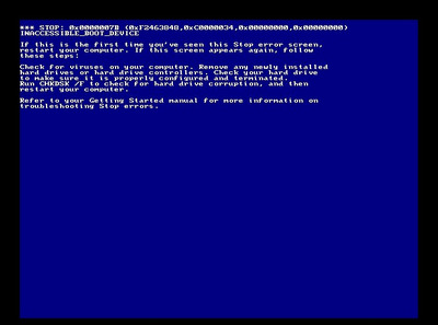

Reply 292 of 622, by superfury
Just tried the Windows 2000 setup again... Something interesting happened (not hanging anymore when starting the Windows 2000 setup's post-loading phase), after fixing the CMPXCHG, CMPXCHG8B and XADD instructions to be cycle-accurate and properly locking. That's directly after setup says at the bottom of the intial file loading "Setup is starting Windows 2000".
1361-Windows 2000 setup BSOD when starting the second phase kernel from CD-ROM.jpg
37.79 KiB
842 views
BSOD inaccessable boot device
So it's having a inaccessable boot device instead of hanging now?

Reply 293 of 622, by superfury
Just took a look at Qemu's way of handling the IDE hardware. I saw a few things:
- ATA Read sector(s) command clears the error register (required for Windows apparently)?
- With UniPCemu itself: setting the device signature cleared the selected drive in the drive/head register(incorrect behaviour).
- Resetting a non-existant drive needs to report non-Ready(incorrect behaviour).
- According to Qemu: Starting a new ATA drive command clears the error register?
So two little bugs with UniPCemu's signature and ready status.
And two little bugfixes found by looking at Qemu(the error register being cleared at executing a new command and after a read sector(s) command(for Windows).
Now the long delay at the end of the BIOS (the i440fx BIOS that is) is now seemingly gone! 😁
Edit: Trying Windows 2000's setup reveals something interesting: it seems to say that it's loading Windows 2000, but no actual disk access or anything is performed at all? The status registers are unread and the error register isn't read as well? It just gives the 0x0000007B (0xF2463848, 0xC0000034, 0x00000000, 0x00000000) STOP error when starting the kernel it seems?
Edit: This might have something to do with Qemu's win2k-hack apparently? Is this the cause of it(too fast ATA IRQs for writes apparently)?

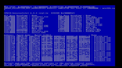

Reply 295 of 622, by superfury
Someone gave me a good tip today: try to use another PC, VM or editor to view the NT 4.0 log files from it's boot.
So I'm going to finish setup on the Bochs machine(also i440fx with 1GB RAM installed), then create a copy of the disk image (to get a bootable NT machine), then use said copy of the machine's event viewer to view the events that last happened when the UniPCemu machine crashes. Perhaps that will show me what driver or file is going wrong?
Setting Bochs to 10MIPS(like UniPCemu) made the setup finish pretty fast. I should be able to view the EVT log using it? Simply let UniPCemu run until it crashes, then use the copy with the finishes Windows NT 4.0 setup(which runs fine on Bochs) to view the EVT log in UniPCemu's copy of the disk image?
Or will the NTFS file systems clash with each other because of duplicate drive IDs?
Edit: OK. No EVT files were created during said failed boot. Perhaps I'll try to boot the Windows NT 4.0 fully installed copy from Bochs using UniPCemu itself? Perhaps that'll result in something interesting being logged?
Edit: Just tried the fully installed version from Bochs. It seems to get past the initial login screen, logging in as the Administrator, but after that it says it's loggin in and crashes with a BSOD. It's giving me:
STOP: 0x0000001E (0xC0000005, 0xA0018748, 0x00000000, 0x000001E0) KMODE_EXCEPTION_NOT_HANDLED*** Address a0018748 has base at a0000000 - win32k.sys
CPUID:GenuineIntel 6.3.3 irql:1e SYSVER 0xf0000565
157.02 KiB
790 views
NT 4.0 finished install at Bochs BSOD at login.

Reply 296 of 622, by superfury
OK. The 1F0 value is the memory address it page faults on(a 32-bit CMP instruction)?
The instruction stream executed is 39 7e 10. It's 32-bit code.
So it's CMP [ESI+10],EDI...
ESI=EAX=0x1E0...
All segment registers are the main boot thread(CS,FS,TR). LDTR=NULL. CR3=0x30000.
Edit: Oh.... Said crash will happen, even when not pressing Ctrl-Alt-Del and logging in. So the issue is somewhere much further down the OS! It has nothing to do with the actual login process!
At least that excludes said cause from the list of causes.
So CR3=30000, Breakpoint at 8:0PI and FS=0:FFDFF000O as the breakpoint settings should in fact log the offending program. The BSOD will always happen, so it's guaranteed to actually log the offending instruction? (The remainder of the settings is as usual:
Debugger mode: Enabled, just run, don't show, ignore shoulder buttons
Debugger log: Only when debugging, common log format
