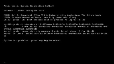

Edit: It compiled and generated the ISO disk image without issues! 😁
Now I have a valid base for finding the issues?
Now I can use addr2line for finding the code locations?
This is what happens on the Master branch:
52.76 KiB
1579 views
Crash on the Minix Master branch
Even with telnet connected, nothing is logged?
Edit: Although, it might have sent something, but since Windows 10's loopback adapter(127.0.0.1) doesn't work properly with a raw TCP connection, it will receive junk instead of the actual sent data(I remember it being some byte value that kept getting received for any byte that's sent instead of the actual byte that's sent).
Although said issue won't happen when it's using a non-loopback adapter connection(like though the public WAN IP address back to the same computer and other instance of UniPCemu, Dosbox or whatever is connected to the TCP server).

Hmmm... My Minix 3.3.0's compiled CD-ROM has different results with the latest bugfixes commits of UniPCemu:
vm(8): panic: vm: boot process load of process rs (ep=2) failed
Then it follows with a stack trace etc.
Interesting!
