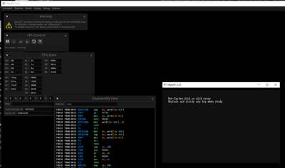

This took a while, but the display framework I've built should be pretty flexible, and it abstracts the backend in preparation for an SDL frontend.
119.96 KiB
229 views
martypc multiple window support
A single video card can be rendered to multiple windows with different parameters. Watch 8088mph in composite and RGBI at the same time! Go nuts!
