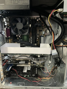

I can never just leave well enough alone and always end up playing around with and tweaking my old hardware.
Anyway for a while now I've wanted to see what the best speed I could get out of this 1.4 is and with a small wire mod to the socket on an Asus TUSL2-C to give it some extra voltage I think I've got my answer. It seems stable so far at 1700, crashed in 3D Mark 2001 at 1711 and it will post at 1733 but will not successfully boot into Windows.
I'll post some pics of the wire mod and the system later today or maybe tomorrow but the specs are as follows:

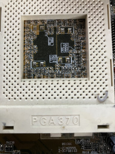

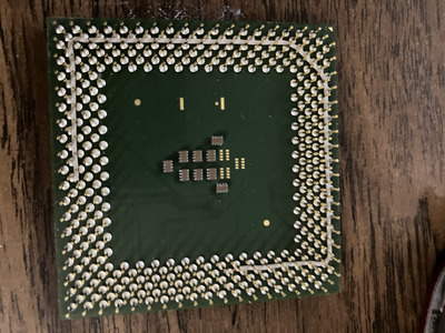

So before I throw out this turdburger of a motherboard here are the promised pics.
I have also tested this same wire trick on MSI and Gigabyte socket 370 boards and it works on all of the ones I have. I cut a section of wire from an 80 wire ide cable to bridge the pins in the socket and laid a section of it in the pins of the processor so it would sit evenly in the socket.
Also just in case here's the site I first got this info on Tualatin voltage mods on from way back in the 2000's! https://www.geocities.ws/tuacubx/reads/MSMG.htm
