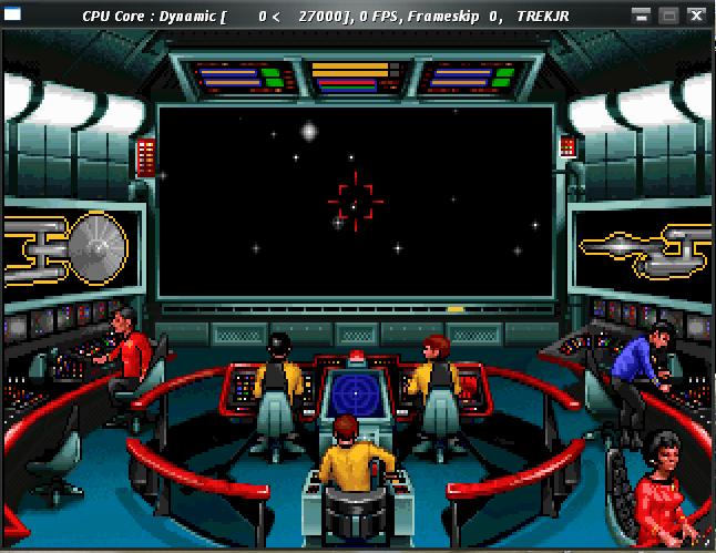

I wonder if per chance you could fix some problems in ST JR and St 25th. Whenever a scaler other than normal2x is on, the graphics become exceptionally cartoony. I'm not sure if anyone aside from me has had this problem but maybe someone knows what might cause a problem like this and how to fix it

JR is supposed to look cartoonish but this is strange. the cartoonish look is weird. I tried taking a screenshot of it but when i open up the png, it looks normal.

these are examples of each. can you tell the difference?
It looks to me like advmame3x antialiases the picture. Neo, could that be explained by the blurring you mentioned?

Yep. That's exactly what the filter is supposed to be doing. Basically it's doing guesswork on how the image should look scaled up, that's what all scaler filters do. Scale2x tends to get a softer image. You might wanna try HQ2X. It's a lot more CPU intensive (but with this patch not even nearly as much!) but it tends to stay a lot sharper than Scale2x or (my typical favorite in other emulators) 2xSaI. Check out the links for examples of both in action. You can see that Scale2x is doing just as you're concerned about. If you don't like it give HQ2X a try or stick to normal.

wait a sec. i just thought of something. I think i figured out why it doesn't look good. Could it be because when the Devs originally created these games, they didn't draw the models to be rendered by such a strong filter so they didn't add an extrordinary amount of detail to the model.
Thoughts?
