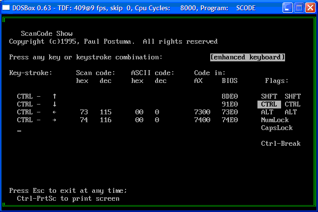

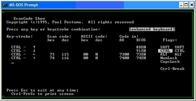

OK. Let's be systematic. Go to this VOGONS post and download the file ScanCodeInfo.zip which is an attachment to the first message in the thread. Un-zip the file to extract the SCODE.COM file. Run this file in your CVS version of DOSBOX to see what CTRL-↑/CTRL -↓/CTRL-↓/CTRL-→ display for the hexadecimal results for AX and BIOS .
Now compare the results with the two screen-shots of the same test for the WinXP NTVDM environment and a late November CVS compile of DOSBOX. Post a screen-shot of your results and we shall know if it is a keyboard scancode problem in DOSBOX or your application has other problems.

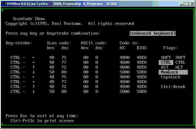

Hello dvjr,
I have tested with the mentioned dosbox cvs release 1 feb 2006.
At first it seemed to work okay with this version. However when sharing this with my friend dos4ever. It did not work okay. It seems to make a difference is dosbox is started with numlock on or off.

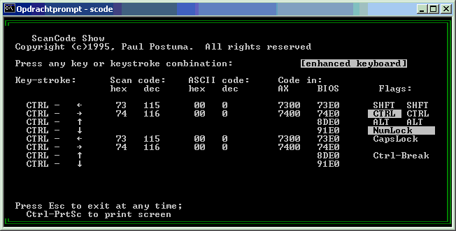

With the NTVDM the results are the same under W2K an WXP, with numlock on when opening the dosbox and with numlock off. This image is NTVDM_numlock_off_at_launch.
The first 4 key presses are the Ctrl-arrow keys (inverted T on keyboard) with numlock off. The next 4 with numlock on.

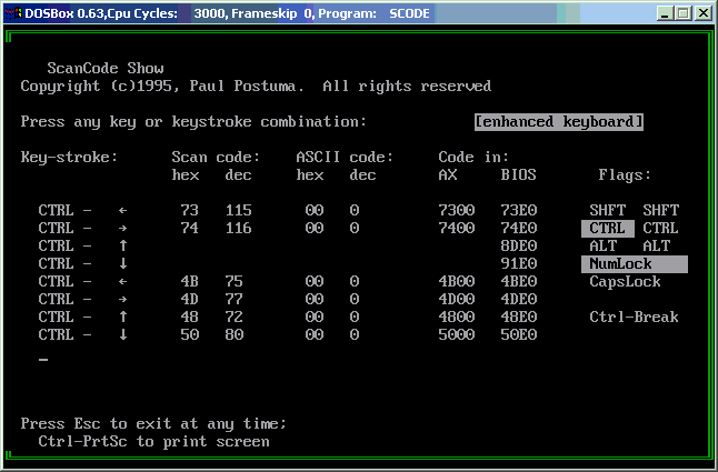

Then the next 2 screenshots are from dosbox.
Screenshot dosbox_numlock_on_at_launch.gif is with first 4 key presses are the Ctrl-arrow keys (inverted T on keyboard) with numlock on. The next 4 with numlock off.
Screenshot dosbox_numlock_off_at_launch.gif with first 4 key presses are the Ctrl-arrow keys (inverted T on keyboard) with numlock off. The next 4 with numlock on.
I see some differences. Maybe this will help.
nipperds

There is a problem with DOSBOX current CVS compile that you are using for your ActSip-H application. There is a short-term workaround which is to use the CTRL-SHFT pair on the RIGHT side of the keyboard instead of just the CTRL key. The NumLock key may be (on or off) when you use the inverted-Tee arrows, the functionality should be the same.
So you want to do CTRL-↑, do a R.CTRL-R.SHFT-↑instead.
