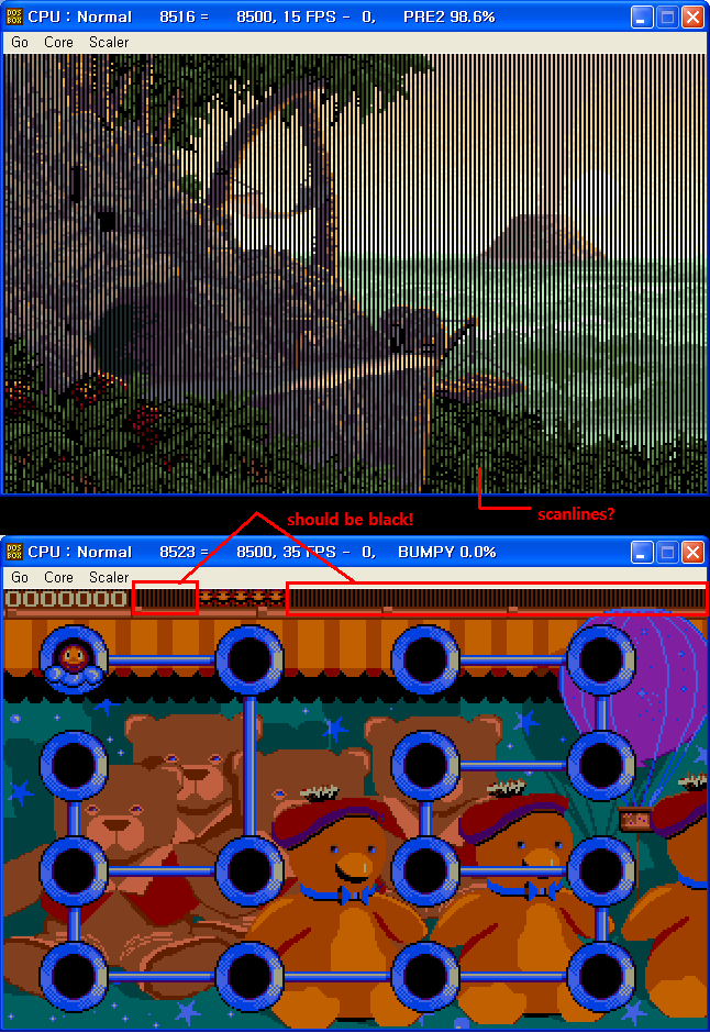

Reply 12 of 44, by ih8registrations
I figured it out; needed to include vga.latch.d in the dirty check.
Fixed tornado. Check it against Prehistorik 2 and bumpy.
    graphicsopt3.diff
    12.21 KiB
    142 downloads

Reply 16 of 44, by ykhwong
SysGOD, if I am right, you applied svga patch, right?
Did you modify some lines in graphicsopt patch against SVGA patch?
ih8registrations, the third patch made the screen of prehistorik 2 much worse. There's still a bug in bumpy.
