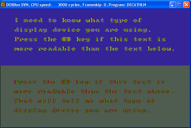

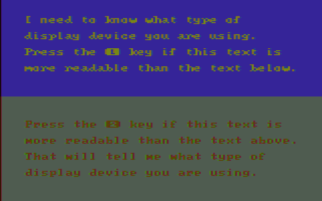

Here's the above-mentioned DOSBox patch. I also added the toggle-key handling from ripsaw8080's patch a few pages back (F12 to toggle composite output on/off/auto).
CGA type ("old" or "new") is adjustable, but not from the config file - haven't had the time to figure out how to do that properly. The color decoding/encoding is exactly the same as reenigne's code, but here I use it to derive the values for the 16 continuous artifact colors, then precalculate the rest of the palette based on that. So this works for all graphics modes and all possible color combinations.
However, the current line-drawing routine uses 80 colors, and this isn't enough to accurately represent every possible pixel color in all modes. This limitation forces us to make a trade-off - here I chose to ensure accurate luminance for the 16 principal artifact colors, but the other 64 (for averaging and edge blending) can't always be accurate.
mode 4 games appear to work fine (left = new CGA, right = old CGA; click for full size):
mode 6 games work as well (no difference between old and new CGA. Note that the colors are different from current DOSBox results, as the 15 degree hue-offset hack is not present here):
background color changes work as expected, and mode 5 games appear in greyscale (new CGA).
In the Jungle Hunt shot, note that the linewise color changes don't work (top text should be white): that would add yet more colors to the palette which we don't have room for.
and here's where it plainly isn't working fine. In MS Decathlon, the bottom half of the display selection screen should be readable using the old CGA code - here it's worse than the top half... the dark blue text in the right screenshot also suffers:
[EDIT - corrected left side image]
I could probably try to fine-tune the precalculation routine some more, and fix up some of the bad fringing; but I doubt that this would actually solve the unacceptable cases, since we just don't have enough palette entries. So, aside from the other issues of color correction and configurable options, the questions are:
  1. Can we do better with 128 colors, while keeping the linedrawing stuff (in vga_draw.cpp) optimized?
  2. If we need more than that, what's the reason for not using the entire palette? do we really need to reserve the 16 RGB cga colors at 0x00-0x0f while in composite mode?
