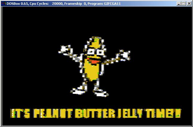

I included two screen shots of my CGA/NTSC animated GIF decoder I converted.
The framerate is horrid on a regular DOS pc, but in DOSBOX, it's 10 times worse.
I'm going to have to re-write the decoder into a transcoder which will create a 640x200x2 data stream (file) that can be displayed much quicker in DOSBOX.
The snapshots are what it looks like. I did watch an animated GIF under emulation though. Twas interesting.

    youtube video transcoded into CGA/NTSC

BTW,.. what do you think of the screenshots of youtube videos? I'm hoping to have the transcoder and viewer done today.

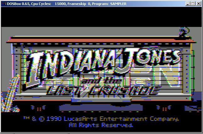

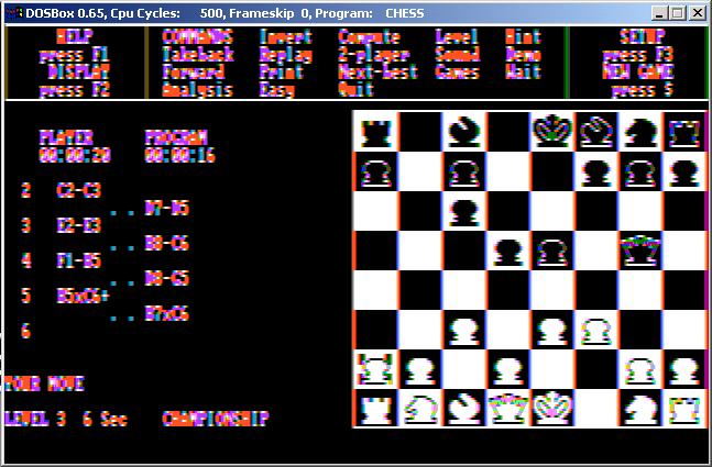

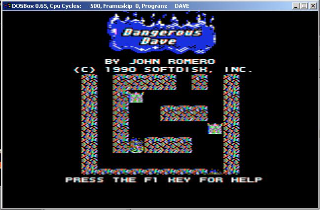

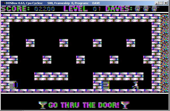

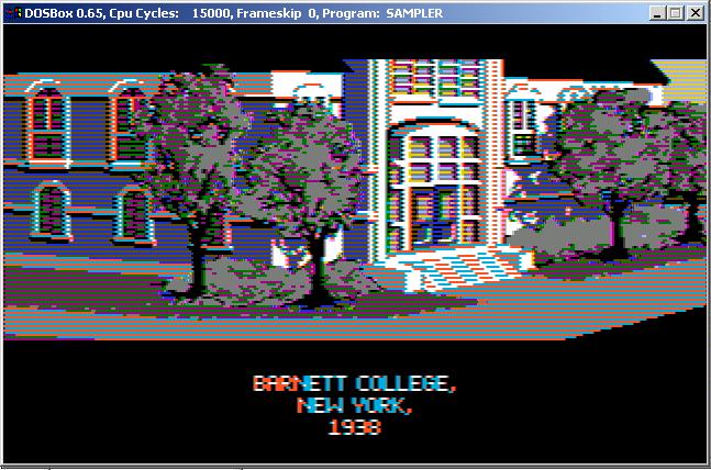

More CGA screenshots.

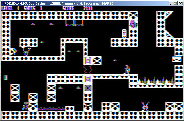

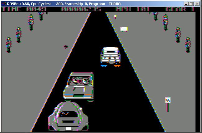

continued..

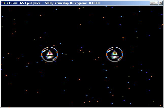

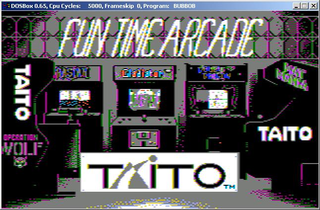

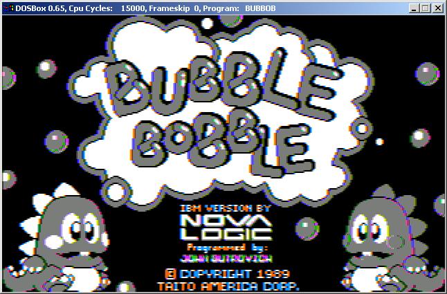

Reply 49 of 753, by KiyoteLockeWolf

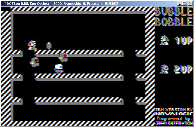

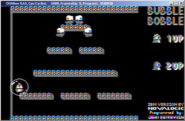

ZOMG.. MORE!!
I think Dangerous Dave might've been made for CGA/NTSC.
Kiyote!

Reply 50 of 753, by KiyoteLockeWolf
99% of those I used COMP6_2.COM, which is Ripsaw's TSR.
Chess is one of the few I used COMPCGA3.EXE, my TSR on.
Kiyote!
[EDIT]
Actually, Bubble Bobble wouldn't run, period, without Ripsaw's TSR.
I got to level 30.

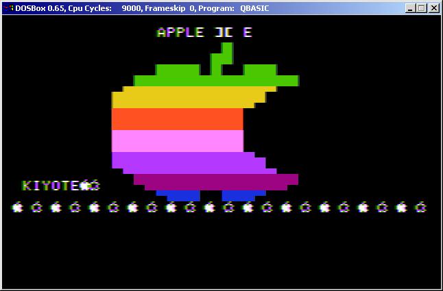

Reply 51 of 753, by KiyoteLockeWolf
More fun with CGA/NTSC..
Simulated Apple screen!
Kiyote!
[EDIT]
I'm supposed to be getting a real CGA card soon from a friend! YAY!!!

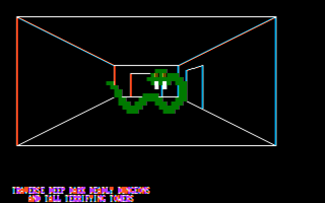

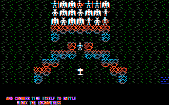

Reply 52 of 753, by HunterZ

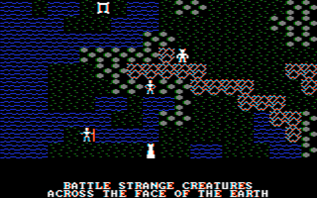

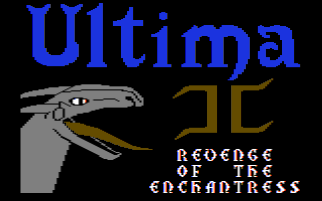

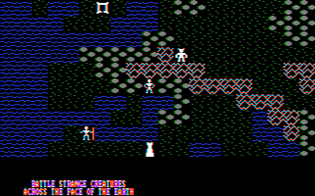

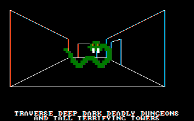

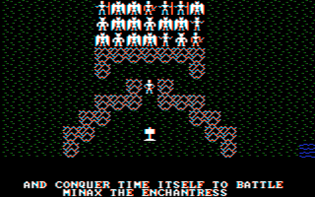

Took a couple screenshots with Ultima 2, which falls under the same category of these other games. Doesn't look quite right, but arguably better than 4-color CGA I guess.

After examining the DOSBox code, I learned that it isn't necessary to switch mode 4 to mode 6 to get composite decoding; just need another port write to generate the composite palette. The attached TSR program will enable the color burst while staying in mode 4, which has the advantage of correct 40-column text instead of the more smeary 80-column text you get with mode 6.
The colors are not accurate for mode 4, and I think that may be for reasons explained here.
We can do slightly better if we sample the signal 1280 times per line instead of 640. This sample rate smoothes out the transitions between colours a little more, but also has the advantage that it allows us to decode colours from modes other than 640x200 palette 15 accurately (something that Dosbox currently does not do).

Would that really make a grey dragon green?
Retook the screenshots with the new TSR:
The author of the blog I linked (who also made some related comments in an old thread) specifically mentions how certain colors can be confused at a lower sample rate. However, DOSBox's current algorithm may not be entirely applicable to mode 4 for other reasons.
