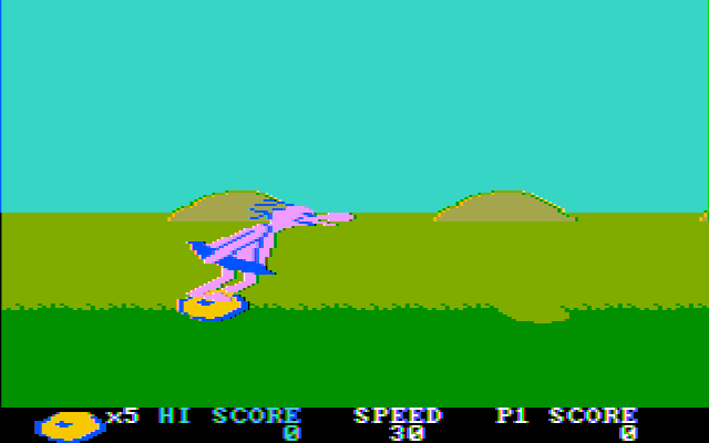

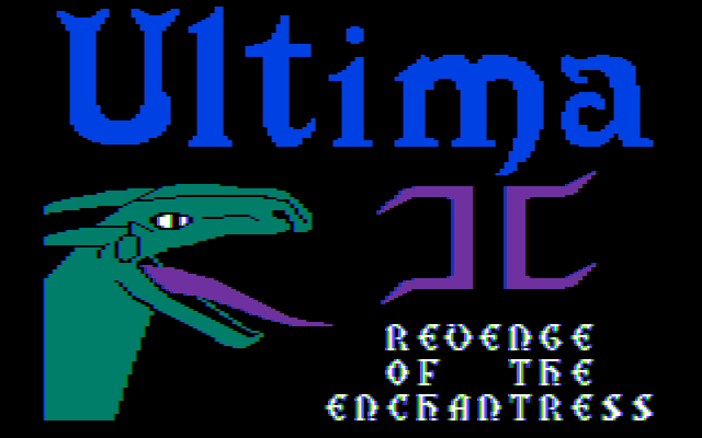

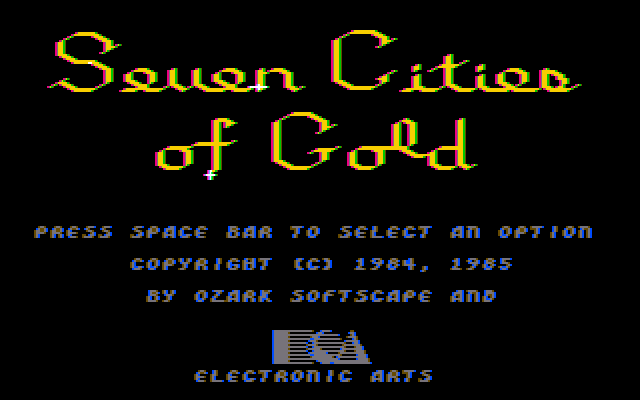

Patch for PCjr composite support, tested with
  • Ultima II (special PCjr version)
    4 KiB
    1809 views
  • B.C.'s Quest for Tires
    3 KiB
    1809 views
  • The Seven Cities of Gold
    3.73 KiB
    1809 views

Reply 683 of 758, by reenigne
NewRisingSun wrote:
I'd like to update the reengine patch as well for its higher artifacting quality, but I don't have the slightest clue what that chroma_multiplexer array thing is. I understand that "It uses a 256-element table of values to describe the behavior of the chroma multiplexer chip on the CGA card. This eliminates the need for all the logic delay and chroma line phase stuff from my previous patch and gives more accurate colours as well.", but it's entirely intransparent what these 256 values exactly mean.
The array element [x*32 + y*4 + z] corresponds to the part of the transition from colour x to colour y (lowest 3 bits of each colour only - the intensity bit is handled separately) at phase z (0 to 3) within the colour carrier cycle. So the samples we get out of this are shifted horizontally slightly from the RGBI pixel grid (this can be compensated for in the decoder if you like, but it doesn't really matter).
Ideally these values should be sampled from hardware in order to capture the full range of behaviour of the multiplexer. I'd like to do this for PCjr and Tandy as well, but I don't have either of those machines yet. Somebody else could do it if they have a capture card that could capture raw samples (ideally a Hauppage ImpactVCB or another card with a Brooktree 848 compatible chip like a Conexant Fusion 878A).
Reply 684 of 758, by liqmat
NewRisingSun wrote:
Patch for PCjr composite support, tested with...
Wow! Nice! The PCjr sound is so much better in SCOG and now with composite enabled this is great! One difference I noticed is the PCjr machine mode composite has more color saturation. Thanks for the file!
Reply 685 of 758, by liqmat
NewRisingSun wrote:
Patch for PCjr composite support, tested with... The Seven Cities of Gold
Just noticed where light blue should be, magenta has taken its place. Is this the emulation or the way the PCjr machine type behaves? Wondering if that can be corrected somehow? If you look at my previous post of the harbor screenshots you see the original r4000 text "MAR. - 1492" with magenta artifacts and in this post the map screen has light blue water. In the PCjr composite harbor scene the text artifacts are light blue and the map screen has magenta water. Its like the two colors got reversed. I have no idea, just thought I would ask. Appreciate the effort.
Reply 686 of 758, by NewRisingSun
The game still seems to be in 640x200 composite mode, so all colors are entirely determined by the particular black and white pixel patterns that the game uses. There is little that the emulation can do about that --- if one modified the pixel clock delay to make that magenta look blue, everything else would look wrong. You will find that other games have even worse differences between CGA Composite and PCjr composite. Below the Root comes to mind.
The approach seems efficient coding-wise, but does nothing to document what the multiplexer actually does; it basically remains a black box. Ideally, one would emulate every aspect of the multiplexer while keeping the efficiency by initially calculating that array's content at run-time in VGA_SetupOther, or defining its content using macros. I assume that some finer aspects may still be unknown however, and that this approach allows one to have accurate emulation without understanding every last detail?
Does the multiplexer behave differently at different stages of the color carrier cycle, or does that array then incorporate a part of the NTSC demodulation?
Reply 687 of 758, by liqmat
I figured it was a Pandora's box. Fully appreciate your explanation and thanks for the file and your time on this. It really is amazing how far DOS emulation has come over the years. The fact we can even get to see these composite modes again in emulation is outstanding. Reliving my childhood currently playing "ICON: Quest for the Ring". A game that achieved 16 color graphics in a unique text mode. (which I originally thought was a composite mode)
