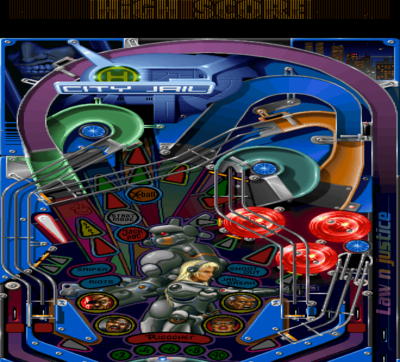

Reply 47 of 100, by Ringding
It is only a configuration issue, but this lets me continue to use the suggested setting pinhackexpandwidth=0.
--- a/src/dosbox.cpp
+++ b/src/dosbox.cpp
@@ -403,7 +403,7 @@ void DOSBOX_Init(void) {
Pstring->Set_help("The Y resolution (height) the pinball hack should trigger at. Default is 350 (good for Pinball Fantasies). Can be a range.");
Pint = secprop->Add_int("pinhackexpandwidth",Property::Changeable::Always,0);
- Pint->SetMinMax(1,4000);
+ Pint->SetMinMax(0,4000);
Pint->Set_help("The X resolution (width) DOSBox will expand to if pinball hack is enabled and triggers.\n"
"Not very useful probably, but provided here in case someone finds a game where it is useful!");
Reply 48 of 100, by sirlee
Finally! I managed to patch my own version, compile it and it works now! (Version 7.4)
Although I am IT professional, being a Windows guy I am really not used to compile stuff my on my own and this proved to be really difficult for me.
As I would have liked to find this exe somewhere but could not, I think I can at least provide my version now.
Use at your own risk 😀

Reply 49 of 100, by zoldalma
Hello,
thank you all for this patch, after some adjustment I have managed to apply it to current SVN build and get it working (under Linux).
For Epic Pinball, use a trigger height of 240 and the expanded height as 420.
For Absolute Pinball, values are 400 and 720 (note: this also makes the DOS prompt look weird)
For Extreme Pinball, this patch is unfortunately not good, game will still try to scroll.
Reply 50 of 100, by bregolin
Just wanted to say this patch is awesome! Thank you felipe.sanches and sirlee for the patch and the compiled Windows binary 😀
IBM Aptiva 2162 - P55 166 MMX, 32MB, CS4237B + Wavetable, ATI Mach64 2MB / Win98SE
Custom PIII 750, 64MB, SB AWE64, Voodoo 3 3000 AGP / Win98SE
Sony Vaio z505 SuperSlim - PIII 550, 192MB, YMF744, NeoMagic 256AV+ / Win98SE
Reply 51 of 100, by zoldalma
I changed the patch a bit, using the earlier suggestion to check the executable name. All games mentioned in this thread are now included, seems to work so far, luckily "pinball.exe" is only used by Pinball Fantasy. (Epic Pinball also uses this .exe name, but when the actual table loads, the executable name is already different). If there is interest, I will clean it up a bit and post.
Some other random observations:
- Pinball Dreams 2 needs a trigger height of 240, I haven'f found a higher resolution version
- if you have a monitor that can be rotated to portrait position, the display will be really neat - Psycho will use most of the screen in, say,1080x1920
- ...but the fullscreen portrait mode is a bit weird in my vanilla SVN build, right part of the screen is not visible (this is not patch related, visible already in DOS prompt)
- so I did a build based on duganchen's fork, which solves this problem, and enables to use pixel shaders, but breaks some games (like Pinball Dreams)
Reply 52 of 100, by sirlee
zoldalma wrote:
I changed the patch a bit, using the earlier suggestion to check the executable name. All games mentioned in this thread are now […]
Yes I would be very interested! Care to share the compiled version as well? 😁

sirlee wrote:
Finally! I managed to patch my own version, compile it and it works now! (Version 7.4) […]
Here is my config file

First of all, big thanks for sharing that compiled Windows version!! 😁
Which patch did you build/compile?
It seems that it only works with games using a height of 350 pixels, like Pinball Fantasies and Pinball Illusions (this one shows a black margin see screenshot), but any other pinball (Pinball Dreams, Absolute Pinball) with different height do not show full table, it does not matter if I set `pinhacktriggerheight` and `pinhackexpandheight` values. It seems to ignore it. It makes me think that EXE is using the first patch, where 350 pixels where hardcoded, doesn't it?
Thanks
EDIT: sirlee compiled version was using hack v1 or v2, so I compiled a new one using v3. It has been attached two responses below
    67.84 KiB
    2834 views
Reply 54 of 100, by DeXteRrBDN
I've tried doing it, but it does not work. The image, on windowed mode works well, but in fullscreen, the image appears cutted more or less at the half of the screen
Reply 55 of 100, by DeXteRrBDN
I've been able to compile DOSBox for Windows using latest patch version and latest SVN version.
dosbox.exe
4.19 MiB
159 downloads
DOSBox - Pinball Hack v3
I hope somebody will enjoy! 😀
I managed to make it work with:
- Absolute Pinball
- Epic Pinball
- Pinball 2000
- Pinball Dreams I
- Pinball Dreams II
- Pinball Fantasies
- Pinball Illusions
- Pinball Mania
- Extreme Pinball (not playable, game still tries to scroll) I'm not sure if the scrolling effect could be prevented with a DOSBox hack...
Reply 56 of 100, by sonninnos
Thanks for this! Would you mind sharing the modified patch also so I could try building it myself? This does not launch for some reason, it just spits error 0xc000007b.
Reply 58 of 100, by sonninnos
Thanks-a-bunch! Got it working nicely now using msys2.
Edit: Darnation, except I can't seem to change the settings anymore via "config -set" command. Very handy for the variable height on different games. Those work with the patch version that has "pinhackexpandheight" named as "pinhackscaleto". "config -get pinhackexpandheight" shows the new value though, but it does not go into effect.
Edit2: Cool, only needed to add true at the end of line 454 in dosbox.cpp, like so:
secprop=control->AddSection_prop("pinhack",&PINHACK_Init,true);
Reply 59 of 100, by DeXteRrBDN
Thanks for sharing the modification!
I've just created a GitHub repo to be able to share easily between us all modifications and updates:
https://github.com/DeXteRrBDN/dosbox-pinhack/ … h/pinhack.patch
I've added your modification at that patch file.
I tried to credit everyone, hope no body cares sharing it at GitHub.
