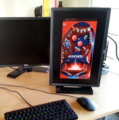

Reply 63 of 100, by sonninnos
Fills the screen just fine here (Lenovo L220x is 16:10):
1.52 MiB
4025 views
I use "opengl" and resolutions on "desktop" and the vertical screen as the primary screen for best results. With "ddraw" the screen cuts at the middle and the scaling is all blocky.

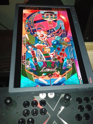

Reply 64 of 100, by xjas
Thanks guys. I forget what scaler I have it set up for but I'll tweak the settings and play around some more.
@sonninnos: nice! It's a bit of a back-burner project for me, but I set this up to build a tabletop pinball "arcade cab" with some suitably chunky buttons for the flippers, etc. 😉 I'll post pics when it's done.

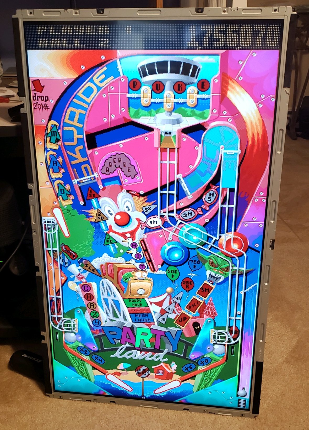

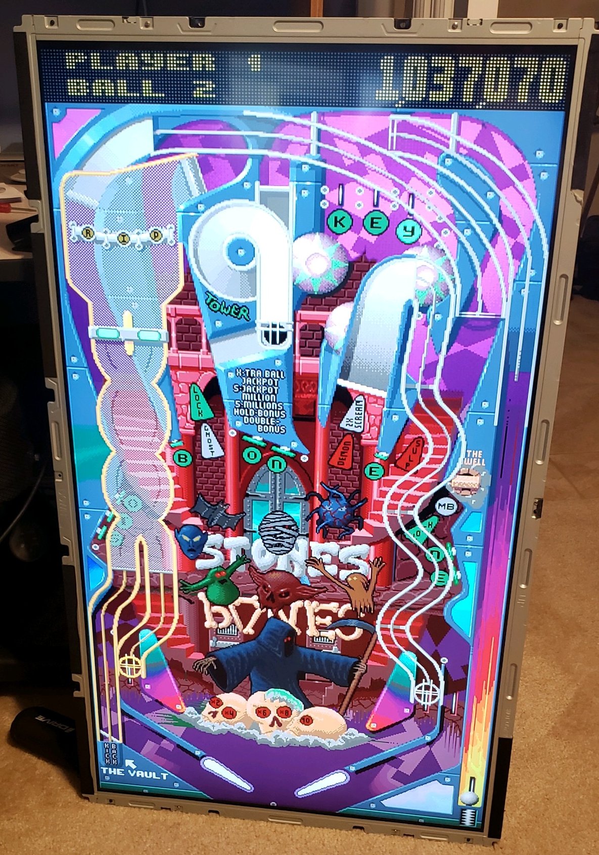

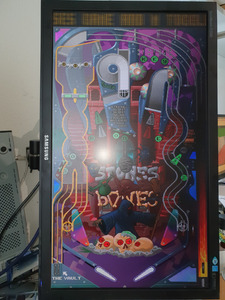

Reply 75 of 100, by RazaXML
Wow thank you guys so much for the work getting Pinball Fantasies working fullscreen. I am currently in the process of building a pinball cab and was hoping someday to be able to play PF on it with no scrolling. I looked it up and found you guys working on this, and with what you guys have posted I got it working in minutes. AMAZING. Thank you so much I've been a fan of these games since they were released (I still have my original PC CD).
I can't seem to post images, but here's a couple of links showing Party Land and Stones & Bones running portrait on the 42 inch tv that will be going in the cabinet.
http://www.razaland.com/images/pl.jpg
http://www.razaland.com/images/sab.jpg
As an additional bonus I found a program called UltraMon that can real time screen grab part of a screen and send it to another monitor. So I will be able to that the score at the top of the screen and display it on the second monitor I will have mounted above. Pretty sweet.
Thanks again for the work guys. Great job.
Reply 76 of 100, by Pierre32
RazaXML wrote on 2020-07-16, 00:53:
Wow thank you guys so much for the work getting Pinball Fantasies working fullscreen. I am currently in the process of building […]
That's just beautiful. Keen to see the dual screen setup when you get it going!
Reply 77 of 100, by xjas
@RazaXML: Oh damn, that is seriously awesome. For my "mini" version, it turned out the TN monitor I was using just didn't look good viewing from the "bottom" in portrait mode. It still works as a vertical arcade-cab type setup, but I didn't end up finishing the project. Really cool to see someone take a stab at building one in full-scale. Please post further updates as you go along!
