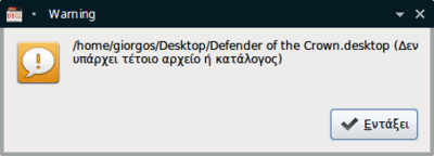

Reply 1199 of 1970, by Giorgos
rcblanke wrote:
- implemented desktop shortcut creation for Linux (KDE and Gnome)
Hi! 😀
It doesn't work here (Mint 17.3 x64 KDE v.4.14.13).
giorgos-Τρι 24/05/2016 02:05 μμ~>java -version
java version "1.7.0_101"
OpenJDK Runtime Environment (IcedTea 2.6.6) (7u101-2.6.6-0ubuntu0.14.04.1)
OpenJDK 64-Bit Server VM (build 24.95-b01, mixed mode)
It brings me the Warning: "(No such file or directory)".
Bye! 😎
G.

    Error screenshot.
