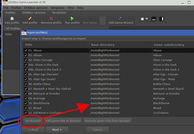

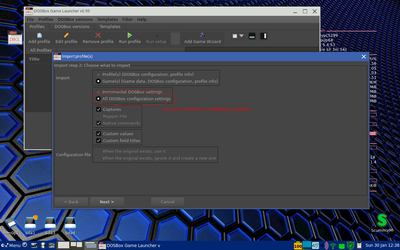

Reply 1747 of 1970, by arobbo
Hi rblanke,
there's heaps to be admired about the latest version (0.95) which I have been testing out - in Puppy Linux (FossaPup64) - with imported *.dblg.zip files from my previous setup in version 0.93beta8 (also FossaPup64).
I ran into a couple of issues that are a problem for me, so I will be staying in 0.93 for some time yet. In no particular order:

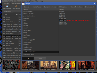

1. Annoyingly I found that all the previous profiles fine-tuned for each game had been ignored in the transfer between systems, for generic 'surface' or 'overlay' defaults - and at 1280x960 - when my poor old laptop can only manage 1280x800. Changes made at the import stage (illustrated) didn't stick as expected...

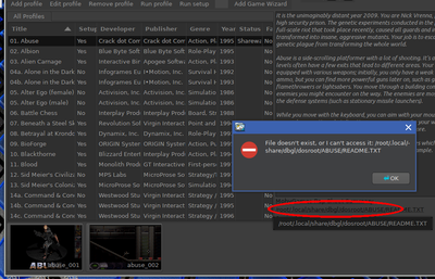

(DBGL 0.95 in linux, feedback continued)...
2. Hidden directories.
Seems that a new hidden directory populates itself as ~/.local/share/dbgl - despite users' selection to another designation. That would be ok if the user had loads of space, but then all/any additional links then *redirect* to the shadow directory. Below I have 2 images to show different stages - the first shows the general output from my preferred selection as /root/dbgl95 - which occurs exactly as intended:
146.46 KiB
3412 views
...but then the database self-populates with links pointing to the shadow directory - where the links to additional documentation etc. provided earlier by the user are no longer valid.

Reply 1750 of 1970, by rcblanke
Onward with 0.96 beta1, the first DBGL version to require at least Java 11:
  • Fixed issue where on some systems, non-relative profile links could be saved. Any such existing links will be corrected on first startup (arobbo)
  • Stripped j7zip, effectively removing 7-zip support for GamePackArchives
  • Updated multiple .jar libs, most importantly SWT to 4.22 which requires Java11
  • Added '*.img' to Floppy Disk Image filter (dosdog)
  • Slovakian translation update by Tomas K.
All the latest files. To upgrade, update dbgl.jar, launch.exe and all files in the lib folder.
Ronald

Reply 1752 of 1970, by Neville
First you need to add the new custom resolution, the option is at File --> Preferences --> Dynamic options.
Then you can select multiple profiles. Click on the first one, then press cursor down + End. Then right click, and go to Display options.
Click on OK and the profiles will now use said resolution.
