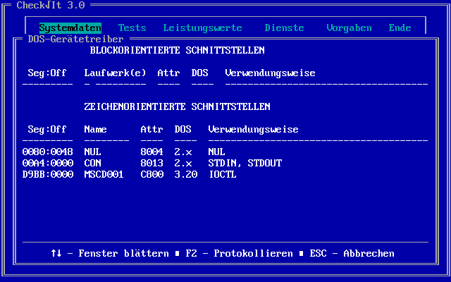

Does anyone know what the CDROM device name is in DOSBOX and if it can be changed?
For instance with MSCDEX:
C:\MSCDEX.EXE /D:CD123
The device name is CD123.
I'm thinking I may have a game which expects to see the device name as MSCDXXXX and fails to run because the device name is different.
Thanks

Device name?? Isn't that the Driver name? So - you say you have games that only works with specific CD-ROM drivers?

IIRC, the name for can be anything you want. As long as it's the same in config.sys and autoexec.bat
What game are you talking about?

DosFreak: True, but since DOSBOX has no config.sys can the device name be changed?
h-a-l-9000: That's most interesting, my game is actually spurting a message in French about MSCD001, so I figured that's what it wanted to see as the device name. Guess it's back to the drawing board with it 😀

The name is not changable, it's hardcoded into the sources. The name
shouldn't matter as there are defined interfaces to the cdrom driver,
and the regular file searching for a block dev works as well.
