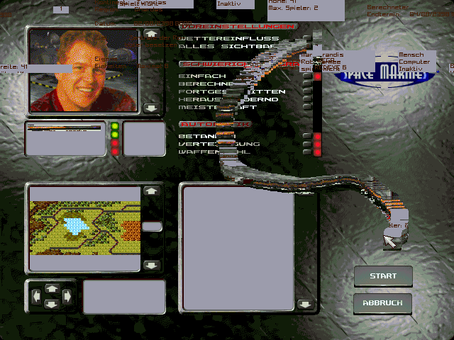

8. Now the problem... well, its difficult to describe, it seem there is a problem drawing the graphics, looks like the cursor is "corrupting" the squares around him. additionally, text is drawn at the wrong locations, and scrolling in the game creates graphical mess. I'll add screenshots 😀
9. The Problem occurs at the moment the cursor is moved / text is drawn / on scrolling

    the "corruption" shows the mousepath

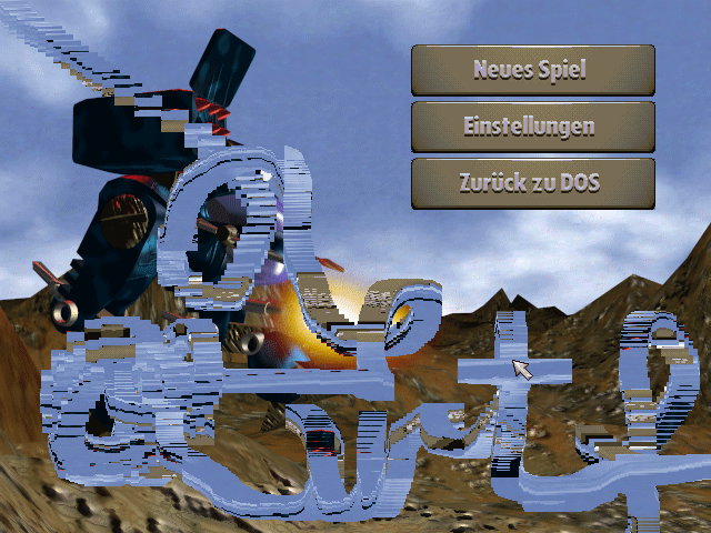

    this one shows the text on its wrong place

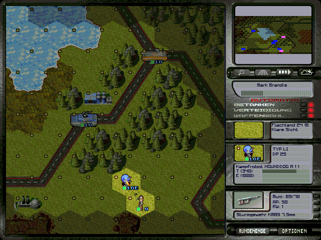

    the scrolling issue. intresting: click on the options button in game, and you're back in dos, with an "error at figure energy" message

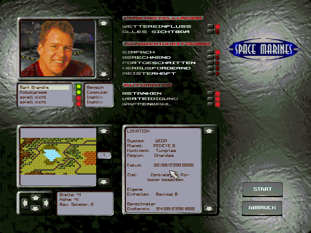

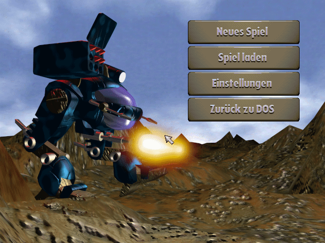

and some other screenshots to prove 😉

    now garbage shown on scrolling. now we can kick some robo-terminator-mech-thingies butt

    the text again, now on its correct place

    no annoying blocks. they're gone for good.
