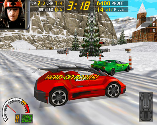

I was wondering if there was any way to stop Carmageddon from suddenly crashing all the time, specifically on the third level?
I've also narrowed down the event I believe that causes the game to crash, its whenever my car or the opponents' cars hit the red and white poles.

There's another post somewhere on these boards that has workarounds that apparently fix the bug when using dgvoodoo. I don't know if either of them would work with GliDOS as Audrey is currently having a holiday at the Sony Repair Centre in France.
It was a user called Dornkirk that came up with this so all credit goes to him, I'm just quoting his post as the original thread is HUGE!
After some testing I found two workarounds which seem to prevent the game from crashing in 'Fridge Racer'
For both workarounds you need to decrypt carmageddons .TXT files using the 'IWANTTOFIDDLE' cheat.
Workaround 1:
Open the file 'ICE.TXT', search for the string 'START OF PEDESTRIAN STUFF', delete all but the first ped and change the number of peds to 1. You will lose all peds, barrels and mines, but the posts will break if you hit them hard enough.
Workaround 2:
Open the file 'ICE.TXT', search for the string 'Non CarObjects', delete the line 'CONE.TXT' and set the number of non car objects to 3. You will keep all peds, barrels and mines, but the posts will be rocksolid.
Personally I'd go for the second one as I don't see the point of Carmageddon without pedestrians!

As jumbles suggested... years ago... I edited my ice.txt to make the poles rock solid and that seemed to fix the problem with the greatest of ease so I could progress through the game as intended. I'll attach my altered version if anyone else cares to give it a try!
Just drop it into your carma\data\races folder and replace the original ice.txt

I can't remember if I ever played Carmageddon when I got my computer back but when I got a reply notification this morning I decided to give it another go and I too can confirm that the 2nd fix works. I've had to edit ICE2.TXT as another level suffered the same problem (I think it's called Chiller) and I have a feeling I'm going to have to edit ICE3.TXT as well.
