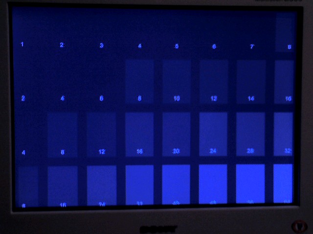

So I ordered my new Dell 2407FPW 24inch monitor on Monday and received it yesterday and hooked it up. The thing I immediately noticed when comparing to my old monitor was that the blacks were actually black....(yeah, pretty funny when I'm comparing an LCD to a CRT and noticing the CRT lacking in blackness...), anyways I've noticed for awhile now that the gamma is too high on my CRT when I compared it to other monitors at work or friends systems but it's pretty much unbareable when I have another monitor sitting right next to it.
I set the gamma setting on the monitor all the way to 0 which helped a little bit but when I set a black background the screen is still pretty grey. Is there an easy way to fix this myself without bodily harm?

Looks like I'm going to have to open it up. I do not have the option in the OSD for the "Image Restoration" feature. My monitor was made in March 2001 (Same year I bought it) so I though I might have gotten lucky but I guess not.

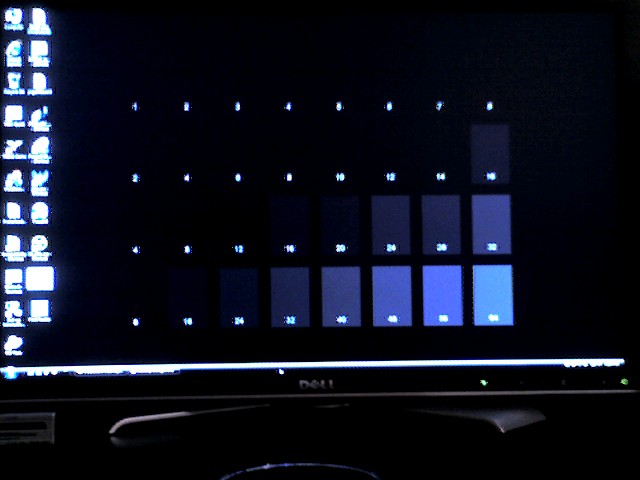

From your pictures it looks as if you have no problems controlling the black-level on your new Dell 24" LCD display. It does look as if you have the Sony Trinitron 'too bright' and no real black problem. The software and interface cable you reference in you post look interesting - a homemade version of the Sony techs' DAS adjustment software. If there is the proper serial port service connector on your Sony E500 you should try getting the cable and try the WinDAS software. It cannot make up for a defective resistor or blown cap, however...
As to the worthwhileness of keeping the Sony E500, that depends on how long the tube has actually been in use. Let me give you an example using myself at work and at home. Most IT departments and many at home have their systems set to go into power down mode for at least the monitors (CRT or LCD) after 20 minutes of no activity. This keeps low the actual number of hours the CRT monitor is using its beam(s) to hit the phosphors. The really determines the 'life' of the monitor. Our monitors at work are setup so, as most probably are yours in your IT workplace to go into power-save/power-down mode fairly quickly. Here at home I have WinXP power down the monitor after 15 minutes with a preceding 'black' screen saver that which kicks in at 7 minutes. Now the electron beam is still sweeping on the 'black' screen saver screen but the phosphors are not being tickled so they last longer. 😀 Then the true 'power-down' mode kicks in and the CRT monitor just keeps the tube and its electronics warm with just a few watts being used. Now on my personal PC workstations I've have had two IBM 21" monitors (made by Sony Japan) and now an 2005 now out-of-production Lacie Electron22Blue IV (rebadged Mitsu Diamond Pro 2070 Trinitron). I expect that CRT to last until a good OLED or SED technology replacement appears to give me CRT-like contrast, black-level, color gamut performance. The working life-span of a color corrected CRT monitor is around 4-6 years. Then they either give out, or become 'gaming' monitors given to young nephews or nieces who now get a 'really cool' huge monitor good for another few years. They are happy with the no 'ghosting' for their PC game system vs the parents LCD display...

Your new Dell LCD looks good in the picture. How is for playing DOS or Windows games? Any motion or ghosting problems? Or has the issue for LCD displays gone away?
