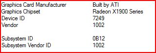

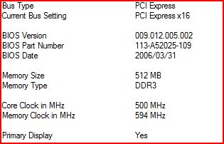

Reply 27 of 58, by laracroft.net
Glidos wrote:
The graphics problems are to do with psVoodoo. If you could get OpenGL working then you'd be better off, but that would probably require your getting hold of the latest graphics drivers from the web site of the graphics chip manufacturer. What graphics card do you have?
Good evening.
I've attached snapshots of the hardware and software details for my graphics card (ATI X1900XT 512MB).
I just checked on the Web: I have the latest drivers available.
I'll download the new VDos32 version now and run it. I'll be back in a few minutes.

Reply 29 of 58, by Glidos
It's not just a case of needing the latest version. Whether you have accelerated OpenGL depends on whether you have drivers supplied via Microsoft or directly from ATI. If you have never updated the drivers yourself then you probably have those from Microsoft.
You can get them from ATI here.
