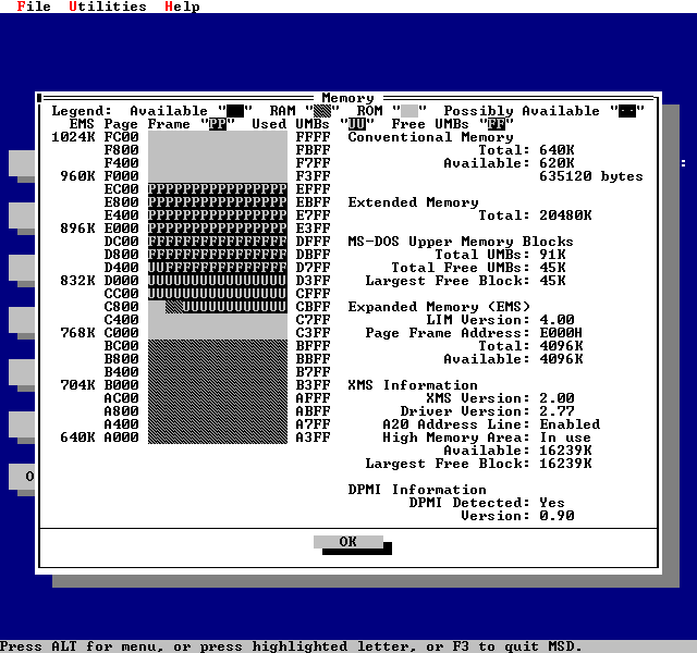

Reply 35 of 117, by vladr
See attachment for what Bill reports in my case. This isusing the default LaunchPad sttings (i.e. EMS + UMBs).
    16.89 KiB
    3749 views

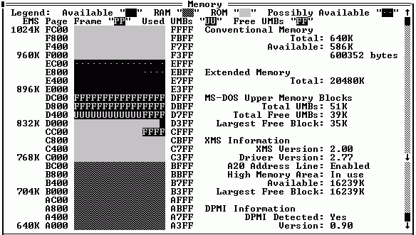

Reply 37 of 117, by NStriker
Unfortunately, I've already tried that, Snover. Not only am I not allowed to uncheck the "Use automatic settings" button in order to manually configure it, the resources don't even show the adapter as using and memory locations. Just a lot of I/O addresses and an IRQ.
Here's what my first meg looks like. A bit different, wouldn't you say?
P.S.- How'd you get it to give you a nice full screen report, Vlad? I had to do a quicky hack together of two screenshots, myself.
