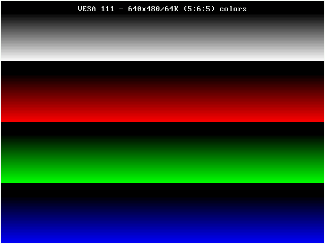

I then tried taking a screencapture of it running with the funny colours under the native VESA support, under dgVoodoo and VDMSound, using Video Thief, which captures the complete graphics card state.
When you view the capture with vtfview (which reprograms the graphics card as at the time of capture), you still see the same colour problems. But if you get vtfview to convert the screen memory to a BMP, the colours in the BMP are fine. This suggests that the data in the framebuffer is correct for a 16bpp mode, but the card's not displaying it correctly.
My next thought was that maybe there was something misprogrammed in the control registers to foul up the output, so I went to find something else that would test mode 111h.

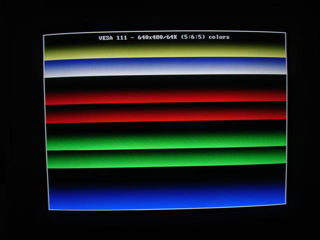

I eventually located VGATEST (which I found in this thread). Its mode 111h test also looked wrong on screen and vtfview, but again the saved BMP was okay.
So if both VGATEST and TR1 are showing duff colours, it seems unlikely that TR1 is doing anything wrong, so that there's probably a fault with 16bpp display in my VGA BIOS.
Looking at the VGATEST colour ramps, it's clear that the red and green channels are incrementing at double-speed and wrapping, so you get two ramps in the space of one. The blue channel is fine. See the attachments below for actual appearance, and what the screen capture reckons it should look like. (Note that the test card actually has black areas between each ramp, which makes it less obvious that the green+red ramps are simply doubled.)
This behaviour would be consistent with this mode 111h actually being a 5:5:5 15bpp mode, rather than the claimed 5:6:5 16bpp. 😒
    142.31 KiB
    2446 views
    Example of duff colours in TR1.
    33.18 KiB
    2450 views
    Photo of VGATEST 5 being displayed
    2.64 KiB
    2450 views
    Screen capture of VGATEST 5 using VTHIEF, and converted to BMP using VTFVIEW. (And then converted to PNG for upload).
