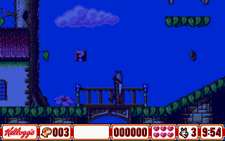

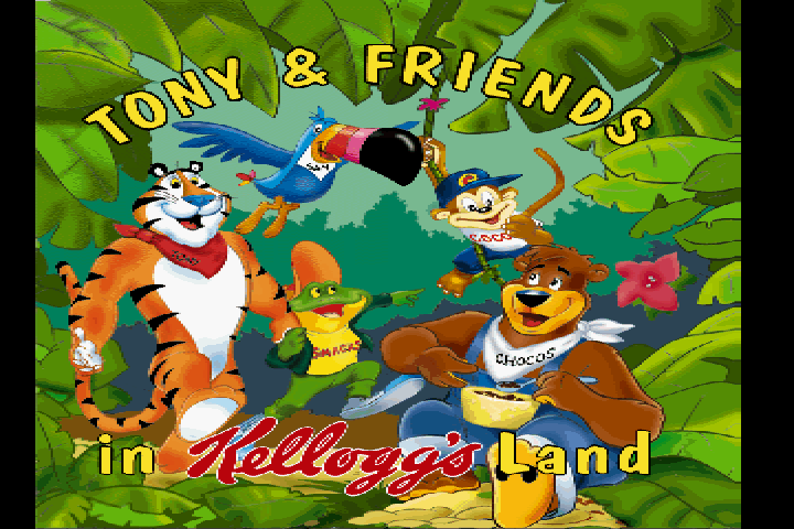

Reply 9 of 19, by eL_PuSHeR
Rank Moderator
Moderator
You need to use CORE=NORMAL.
    5.97 KiB
    1327 views

Reply 11 of 19, by eL_PuSHeR
Rank Moderator
Moderator
I don't know why the second capture is borked. It showed fine when playing, though.
