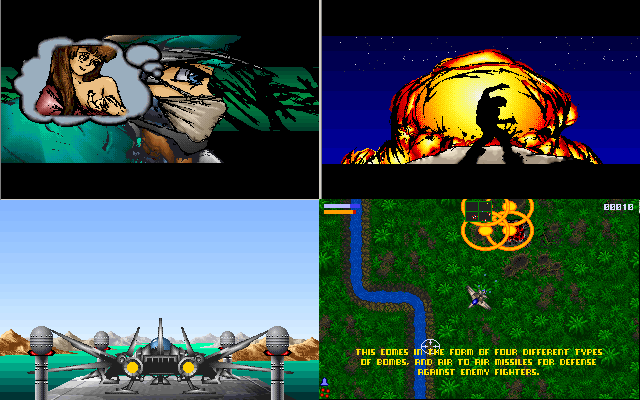

Reply 5 of 13, by Nicht Sehr Gut
Oops forgot to mention, if you have VPC5 and don't mind dreadful PC Speaker+AdLib audio. It will run on VPC. All the restrictions mentioned apply and you must run it with the "a" parameter:
ZONE66 /a
Trying to run it normally (autodetect) or with the "s" parameter resulted in instant lockup.

Reply 7 of 13, by Nicht Sehr Gut
Originally posted by HunterZ ...he's having fantasies...
He's running to save his wife and child who die horribly in the huge explosion in the image on the right...
*mumbles*
heartless sob
