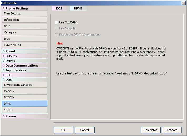

Anyway, when I try to run Diver Down I get this strange error message:
Load error: no DPMI - Get csdpmi*b.zip.

Just use D.O.G. if you're totally lost.
D.O.G. comes with CWSDPMI included. The site from witch you can download it is in the About freeware dialog.
Just activate "Use CWSDPMI" to make D.O.G. run CWSDPMI before running the game. See screenie.
You can find it here : http://clio.rice.edu/cwsdpmi/

Reply 5 of 5, by HunterZ
The easiest solution is to get CWSDPMI from the link that ErikGG gave, and unzip it into the folder of the game that wants it. The game will automatically use it.
The game should have came with it, unless it was expecting you to run it from inside of a Win9x command prompt.
