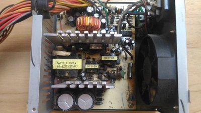

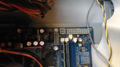

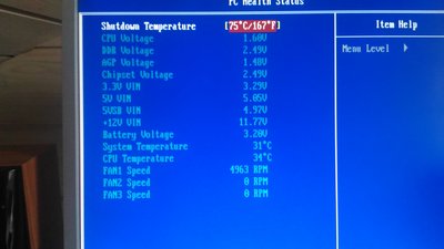

Got a Socket 462 PC for a highly extortionate price of 1 Euro.
1.85 MiB
602 views
I didn't really need any more socket A stuff and it's just a basic 1666MHz Axp with a GF MX440, however what caught my eye were the power connectors:
2.07 MiB
602 views
And the motherboard was reporting a healthy looking 5.05V on the 5V rail with the 12V one not looking so great.
1.82 MiB
602 views
The PSU powering it was pretty darn gutless...
2.47 MiB
602 views
...so I assumed it was really one of those rare 462 boards that power the PSU from the 12V rail (yay!). However after disconnecting the 4pin plug the PC booted up just fine anyway.
Does this mean it still uses 5V for the CPU? The board is a Shuttle AK37 and I can't find much documentation on how its powered, so if someone ever came across this board and have any info on the CPU power, I'd be really appreciate it.

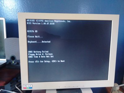

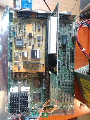

I bought a box full of computer parts for 5 bucks at a garage sale. It contained all of the internals for a Pentium 60 Packard Bell. They didn't have the case, but at least they still had the PSU.
It has an integrated vesa local bus Cirrus Logic CL-GD5434-HC-D with 1 meg of vram( 2 upgrade sockets ) and 24 megs of system ram. Everything worked, was kept in static bags, and it just needs a new CMOS battery -- which I'll replace once I buy a real soldering iron and get in lots of practice. 😀
This is the motherboard:
http://www.uktsupport.co.uk/pb/mb/520r.htm
I noticed that the heatsink seems to have been glued onto the Pentium. I was wondering if there's some way to remove this? Or maybe it's just super dry somewhat clear paste? I would like to apply newer thermal paste once I get around to cleaning this up and putting it into a case.

Yes, even with the P4 connector on some socket 462 motherboards they still heavily convert from the +5v rail in all of them. I don't technically know why some socket 462 boards even have the p4 +12v power connector. As you saw by unplugging it most of the cpu's don't even use it at all.

Sweet find! If that board is LPX it shouldn't be too hard to find a compatible case. Hopefully. Try warming up the CPU with a hairdryer on the highest setting until you are able to twist the heatsink off.

If you got a multimeter you can try measuring the resistance between the 12V connector and the capasitors on the edge of the board (I guess the are for filtering on the 12V/5V side). Nice board BTW, I kind of like VIA chipsets.

None of these socket A boards actually use the 4 pin 12v plug for the CPU. They run the CPU off the ATX connector, witch is why it's very important you get a PSU with a strong 5v rail regardless if the board has the 4 pin CPU connector or not.
