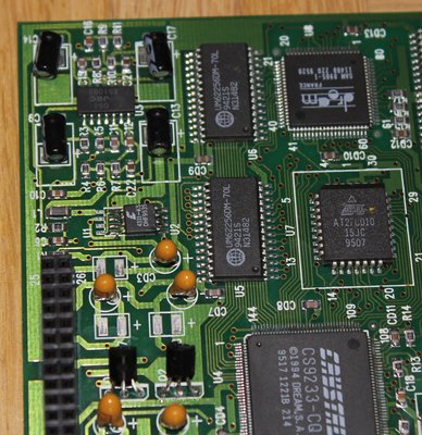

derSammler wrote:
Might be just the light, but on the picture it looks as C13 has a small dent in the middle. In this case, it must be replaced as it would cause a short inside the cap.
U1 is skewed. Soldering points are not original, it was probably re-soldered in the past. The upper four pins seem to have too few solder, the other ones have too much. I would de-solder it, clean the pads, and re-solder it properly.

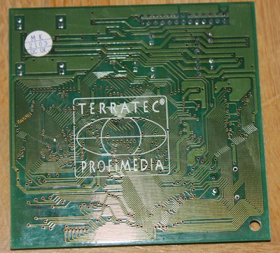

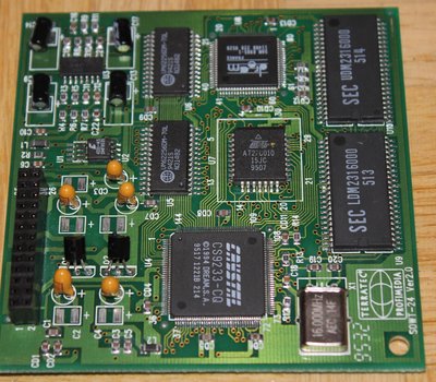

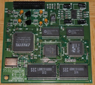

So I am still trying to get this SOWT-24 running.
To remember, all Caps, power regulator and the crystal were removed when I got the card.
I replaced them all but its still not running. I tried in a Aztech and a Soundblaster 16. As far as I understood it should run without additional driver when selecting Waveblaster / General Midi output on port 300/330 in a game - correct?
- do I have consider the direction when mounting the crystal? I think it should not matter?
- can somebody confirm I have chosen the correct Caps? 16V, 10uF? I have no photo where I can see it on a reference card.
- is the power regulator 79L05 the right one? I am very unsure about this as the previous owner used the board for his soldering pratice and a 79L05 was still installed. But maybe he replaced it already with a wrong one?
I dont think the soldering of U1 or the black caps are the reason. They are looking good to me and connections seem to be fine.
925.26 KiB
1670 views
834.71 KiB
1670 views
618.59 KiB
1670 views
818.58 KiB
1670 views
I dont think the card is damaged. After closer inspection I noticed nearly all cards of this lot were used for "soldering practice". And I was able to repair all I tried by removing excessive solder...
Mabye I should open a new thread, not all will look here...
Thanks!
