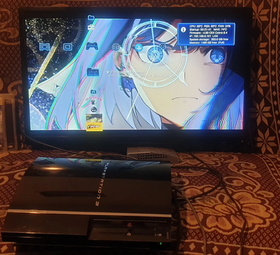

Speaking of bought - I won a CECHB00 japanese PS3 - the one with the absolutely GORGEOUS black trim!
Downside would be no card reader and WiFi, though I'll probably dive my nose into that as I have some spare CECHC04 parts to tinker with, and IDPS changing to a CECHA00 would be something cool as hell to find out how to do.
First thing in order though, swapping the PSU inside for a PAL unit - I'm seriously not even thinking of running a japanese PSU on 240V AC. Even if the PSUs is claimed to be universal voltage (100-240VAC)
That, and it supposedly YLODs. Depending on the duration, it could very well just be rotten NECs like my current CECHC04 has - this one IS CHOCK FULL of 1001 and 1002 errors in the syscon log.
Picture shown is my current CECHC04, that'll hopefully undergo capacitor surgery soon. I'll resort to doing only the topside NECs to avoid doing the wire bridge, and that should be helpful enough, I suppose.
Funniest and most ironic fact - the HUEG 203W power brick I use for my large stack o' 360 phats is barely audible compared to the slim's brick - even when used on the most fiery Xenon EXT_CLK unit I have. (which I should swap the HDD on soon enough - that 500GB Samsung inside it seems to be on its last legs unfortunately.)

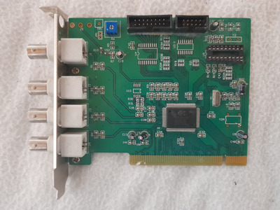

Today I got this Conexant Fusion 878A-based 4x BNC PCI capture card. Opinion?

Looks like a generic card without the audio in or video out...
I foung this post that might be useful: https://forum.videohelp.com/threads/169623-Co … ant-fusion-878A
Should work under Linux out of the box?

Yes. It can work on Linux out of the box because I have a similar old TV Tuner card that works out of the box.
And maybe I can use the generic BTWincap driver.

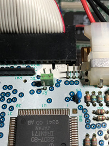

DerBaum wrote on 2023-11-08, 22:39:
Is it possible that you measure some connections for me? just beep out some things. nothing fancy […]
CharlieFoxtrot wrote on 2023-11-02, 18:36:
I have one 7193-U and it is manufacterd in 1993.
1 is the Pad on the test connector
2 and 3 are the missing pads
4, 5 and 6 are vias.
I made a small chart of the measurments i need.
1 to 2,3,4,5,6
2 to 3,4,5,6
3 to 4,5,6
4 to 5,6
5 to 6
Thanks in advance.
I expect:
1 to 6
2 to 5
3 to 4

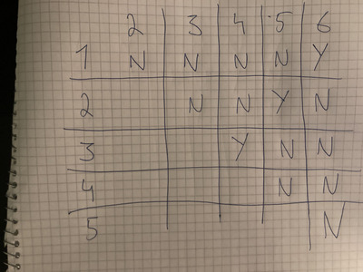

I can report success!
Charlie sent me over the measurments:
1.42 MiB
1514 views
Thank you very much! That was the last piece of the puzzle.
It confirms my predictions and i am now sure it wont fry anything.

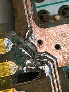

I soldered wires to the points
935.07 KiB
1514 views
covered everything with white paint and connected it to my test pc...

The Teac drive is working again!!
AND i can confirm that the missing pins are indeed needed.
To test if the pins do something i covered them up with capton tape and tested the drive again.
1.64 MiB
1514 views
Now the speed selection doesnt work anymore, it always spins at 360rpm and does not go down to 300 if , for example IMD tells it to spin slower.
And that is the feature that makes these drives great. Dual speed operation.
This confirms :
A. Pins needed
B. Repair successful
Thanks to all involved vogonians 😀

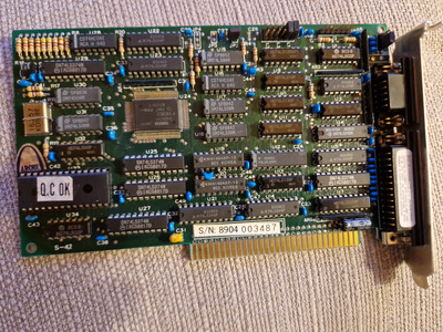

I've just received my ISA graphics card, it is based on a Yamaha V6363 and can do Hercules MDA and CGA. Hopefully if it works I'll be using it as a backup video card on my P200 build (which at the moment is non funtional).
Technically I did not buy it. I forgot about it many years ago and retrieved it in a box full of old stuff while looking for something different.
I am in shock when I see the price of similar cards on the net... I've seen sellers asking 50-100 bucks for it. This is insane. So sad to see the limited offerings for "vintage", retro computing parts and the silly asking prices.

You sound like a glutton for punishment if you want to use a CGA/MDA card on a P200, unless it's only running DOS or an early Linux 😀 Great that it's HGC compatible though.

late 90s linux was fairly bearable on hercules with xfree86 and fvwm or something basic, was as useable as a mac classic anyway. It was better than if you had some spectacularly unsupported 256kb VGA I think that it could barely do 16 colors on the 640x480 mode... mainly because everything expected VGA to do better so everything looked nasty... the extra 10% horizontal res helped also.
