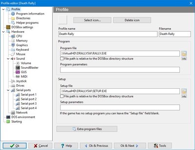

Reply 2221 of 2255, by svfn
Hi, I have found that in Windows 10's High Contrast mode, the "Choose File" buttons in Profile Editor>Profile and Starting section don't open, does nothing when clicked. But disabling High Contrast and the buttons work normally. The buttons in Profile Editor>Directories work regardless though.
