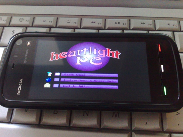

Since you wanted to see what games people would run on your port, here's my phone running http://en.wikipedia.org/wiki/Heartlight_%28game%29!
A little slow, and no way to actually control it, but awesome, so awesome.
