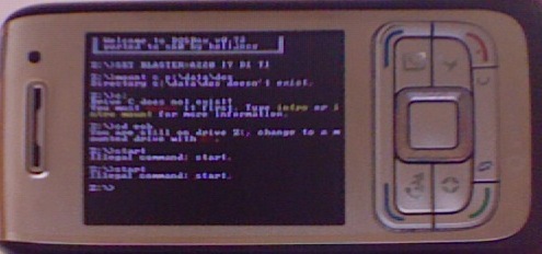

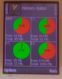

Reply 46 of 197, by gregd72002
Wow!! Works on my E65 with only 15MB RAM free (currently as I've got other apps running)!!!
Was just wondering about T9 - is it possible to support it somehow?
    25.29 KiB
    12707 views
    Only 15 MB ram!!
    34.22 KiB
    12707 views
    and it runs :)

Alright, but I'm not able to run any program. I've tried:
Magic Candle II - the setup runs well however after running the game itself dosbox quits without any error
X-com - dosbox quits after showing "Sound initialized" or so...
Magic Candle I - my mobile makes 2 strange sounds (probably generated by the game) and dosbox quits. Nothing is displayed though....
... is it that to initiate 13h mode dosbox requires additional memory to allocate? How much?
