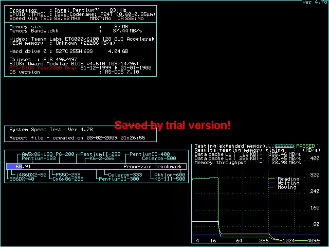

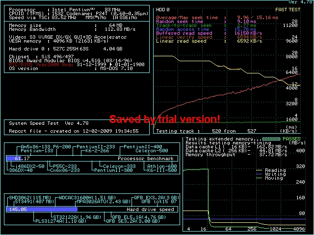

Reply 22 of 39, by 2Mourty
I redid the test and here are the images. One test is at 83mhz and the other at 100mhz. I also did a cachechk test. It said that my L2 cache was active, but that I only had 16k of L1 cache.... Wierd.
I redid the pc player test at a 100mhz and the score was a 9.9
Also I agree that the pentium fpu is heads and shoulders above the 486 fpu's for 3d games. One of the reasons I tried the 83 POD was becuase as a 10th grader I was so frustrated that my dads 133mhz 486 could not really run any games that requred a 60 mhz pentium. With the Diamond Monster 3D card and the POD Jedi Knight runs very smoothly and is quite playable. I remember trying that game on my Dad's 486 (shudder).

Reply 23 of 39, by swaaye
Pentium L1 is a split design. In the Pentiums with 32KB L1, you get 16K for data, 16K for instructions. So in this test you see the 16K half for data.
Older processors usually have a unified L1 so you see all of it in a test like this.
Looks like your L2 is working alright. Check out that massive disparity between the performance of the L1 and even the L2. Yikes.

Reply 25 of 39, by 2Mourty
Quick update. I set the L2 cache to write-through instead of write-back and memory bandwith tripled. Wierd huh? Anybody have any idea why? Other scores went up a bit too.

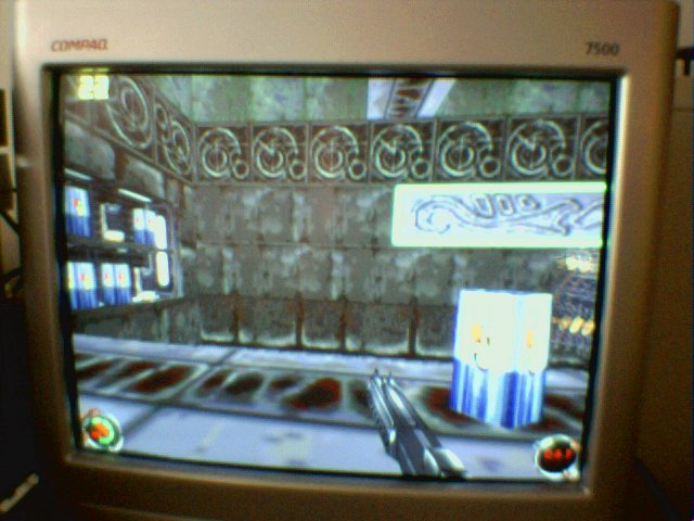

Reply 31 of 39, by 2Mourty
Just a quick update to show the improved performance with L2 cache actually functioning. These 2 pictures are from Jedi Knight. The game is running with the Diamond Monster 3d Voodoo1 Card I have on this motherboard. I apologize for the pictures quality my little digital camera stinks.
The first shot is in the bar at the beginning of the game if you cant make out the fraps digits it says 22. The second is outside the bar and the digits are 30. Not bad for a socket 3 motherboard and a CPU going at 83 mhz! 😉
